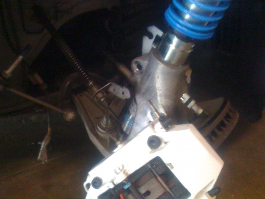

when you say spindle off ball joint, you mean the far right piece in this pic:
maybe my terminology is wrong but i always called that the tie rod... or are you talking about the left one in pic that goes to the back of hub.(looks like sway bar). or the forked piece going to bottom on the control arm?
i see he went a lil overkill so seeing which you say is the one to remove to slide out.. thanx.
also whenever i remove a tie rod. the other end just "spins" in the end.. so i usually have to apply pressure from one side with like a jack to get the nut to thread all the way tight... is that a problem at all on this car? i always over analyze stuff before hand so going in i know exactly whats what so i apoligize for the excess of questions..
No, it's the top piece. See the bolt with the thread lock on it. There is way more stuff removed in that pic that needs to be IMO.
k... sick.. that looks like connected to the sway bar kinda at this angle..

It actually is a lot simpler than it looks. Once that ball joint is slid out all you have to do is make sure you also removed the brake sensor plugs. I had to push down hard to compress the shock to be able to get it past the fender and out at the angle like you see below (sorry for the crappy pics):
Yes, that disconnected joint is the tie rod which you also have to remove. The spindle or carrier assembly is sitting on the ball joint, you can see the boot at the base of the carrier. You need to pull it off there, get the carrier off the control arm so that you have room to drop it down a little to clear rotating the assembly out of the fender well (or put a hell of a lot of downward pressure on the control arm to clear the fender, but i think it is easier to just pop the assembly off the ball joint) I would get a tie rod separator (not a pickle fork, it can damage the boots) from Harbor freight for like 20 bucks. One of the best tools you can have in the box when doing suspension work.
