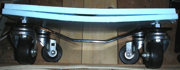

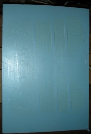

Verde, the car was stored for 6 month.. I took out of storage 1 month ago.
I to agree, I must have not been as observant the end of last year as this year and storage is probably not a factor in the diagnosis.
I stored the car on dollies with Styrofoam to distribute the weight in half evenly on each dolly. See pictures.

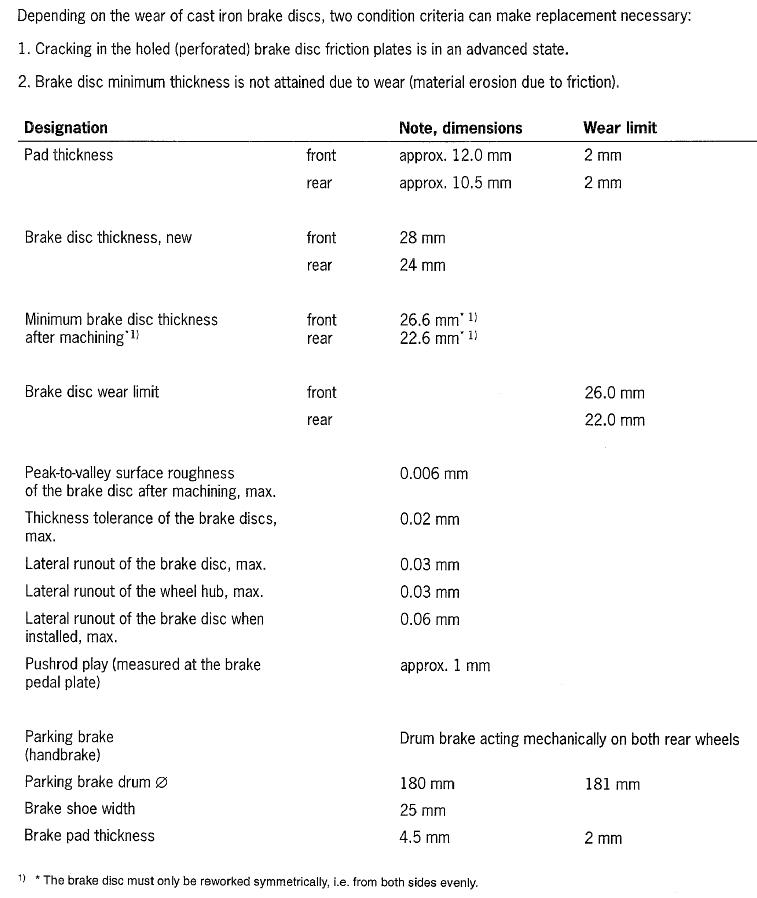

I found the quintessential element missing for the solution, the allowance. I found this on another website - keep in mind this is for the 996 but I believe the allowance would be the same. (see attached)
In addition, the following article sounds like what is happening to my car. Also good reading for anyone in the future searching 6speed for a problem like this. (Click here)
I will not be 100% sure until I replace the rotors, however I am confident that this is the problem and reading that .003" is unbelievably bad I am convinced enough to move forward with the replacement.
