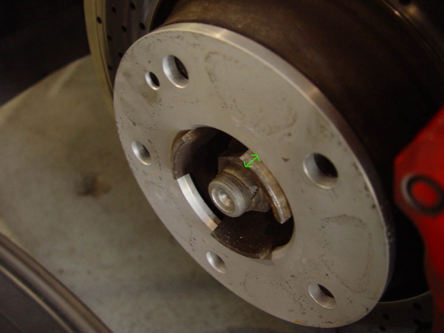

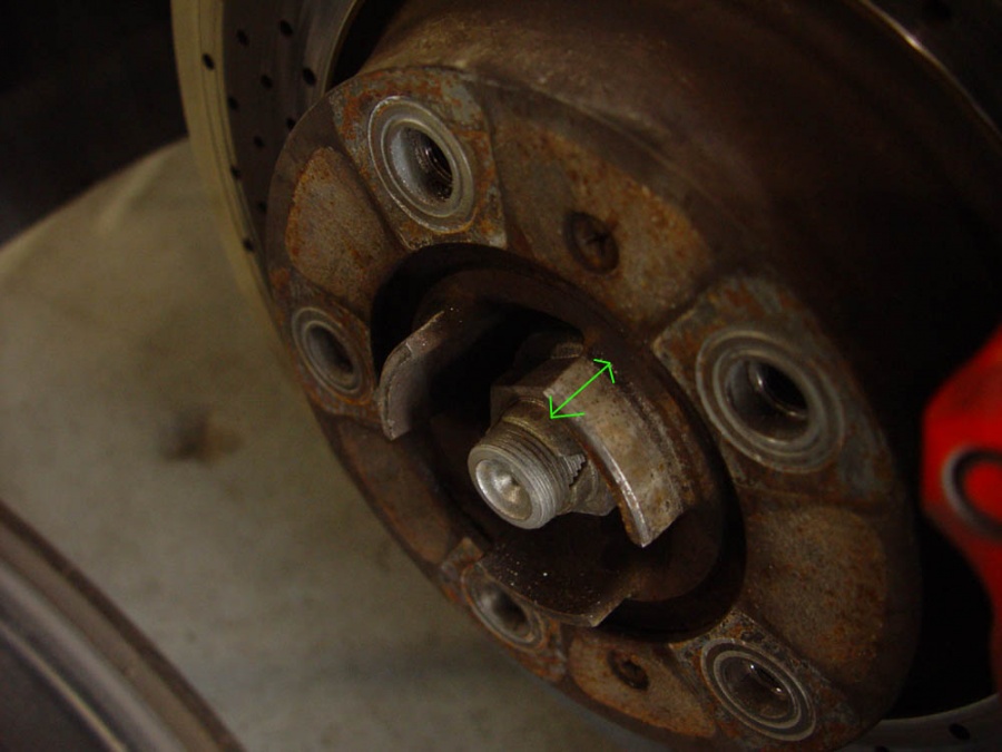

Follow-up solution
Hi All,
Well, as it turns out the front spacers are probably not going to work. After the spacers are installed their isn't enough of the wheel guide left to center the wheel properly on the hub. As you can see from these photos...
Dang, I really like the stance the front had with the spacers, but we're not seeing how to get the wheel centered on the hub perfectly. If anyone has any ideas that would be great!
Carl

Old Jun 4, 2009 | 08:27 PM
Dave07997S's Avatar
Joined: Dec 2006
Posts: 1,723
From: Playa Del Rey, Ca
Rep Power: 107
Dave07997S has a brilliant futureDave07997S has a brilliant futureDave07997S has a brilliant futureDave07997S has a brilliant futureDave07997S has a brilliant futureDave07997S has a brilliant futureDave07997S has a brilliant futureDave07997S has a brilliant futureDave07997S has a brilliant futureDave07997S has a brilliant futureDave07997S has a brilliant future
Originally Posted by hoeferland
Hi All,
Carl
PS I'm currently running a set of Carrera Sports (8.5;11.5) http://www.wheelenhancement.com/inde...lDetail&id=166
The Eibach's are hubcentric...see my post above.
Dave

Old Jun 4, 2009 | 09:38 PM
NorthVan's Avatar
Joined: Jan 2008
Posts: 8,875
From: Vancouver
Rep Power: 684
Hi All,
Carl
Carl, I am running the same spacers on my car, and I have not had any wobbles at all. I agree that there is very little "bite" but they seem OK.
You could probably get away with a wide hubcentric spacer in the front.
