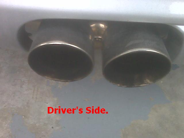

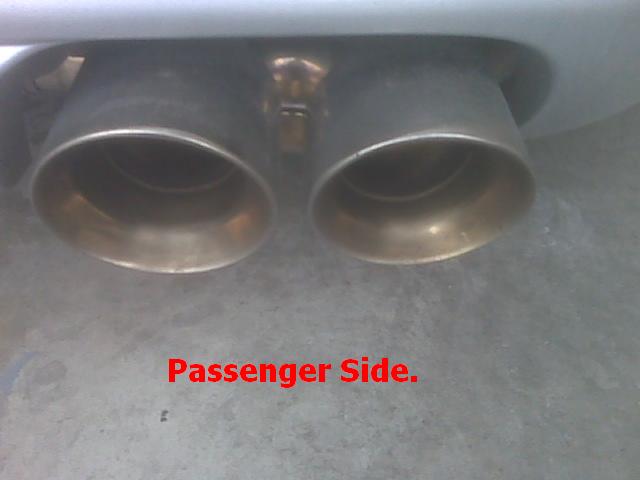

After a day or two I noticed the drivers side exhaust tip had some heavy soot starting to build up and nothing on the passenger side (clean). I talked to my tuning shop and they had me come right in and re-loaded with a different version of the GIAC sofware. Anyways...car still feels great but I have this mystery soot build up on the drivers side exhaust tip.

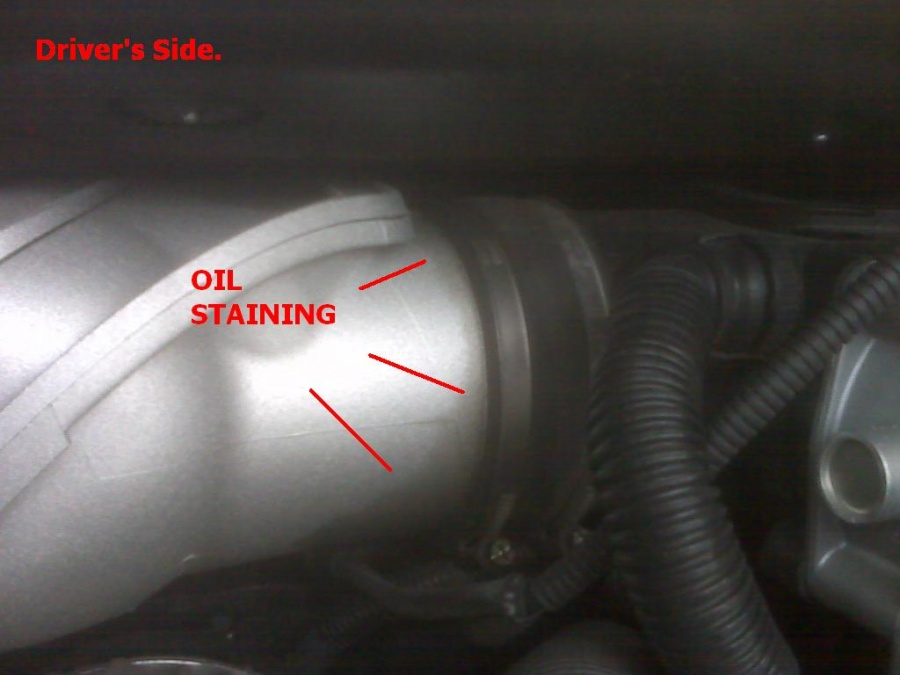

I started peaking around the engine bay and just noticed that I have what looks to be some oil staining on the ...pardon my terminology ....the intake side, post throttle body / plenum - driver's side.
This makes some sense as the sooted exhaust tip is driver's side as well.
Any idea what is happening here?

Please see attached pics.

You drove for a month (you don't mention milage) and if it is an 08 it must have preowned miles on it. You saw no problem. You had mods installed and now there is a (very noticeable) problem. Seems obvious to me. Off the mods and see if it goes away. Find out why intake is leaking. It should not be. Sounds to me like shop mis installed something. I see no connection w the out of round issue. I suspect the intake is messed up. Please report back.

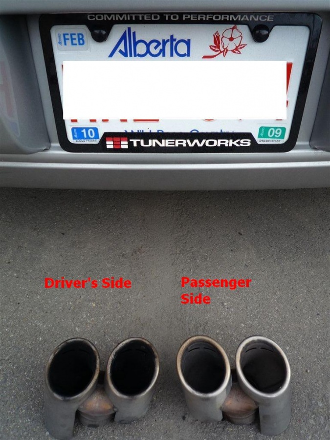

Update : Pictures of Stock Tips
Well looks like my stock tips show the same caliber of soot build up.
Car is booked in next week at the porsche dealership for a look and see.

Car went into dealership today and upon inspection I received a phone call this afternoon that my dealership sent the borescope camera footage to Porsche Germany and Porsche Canada and requested a new engine be sent to be installed into my car.
They didn't indicate exactly what the problem was (will probe more tomorrow) but was told once this caliber of request is made they have never been turned down.
Nearest engine is in Texas and look like will be 7-10 days for delivery then install booking.
I guess my sooted exhaust tips were worth looking into deeper.....
