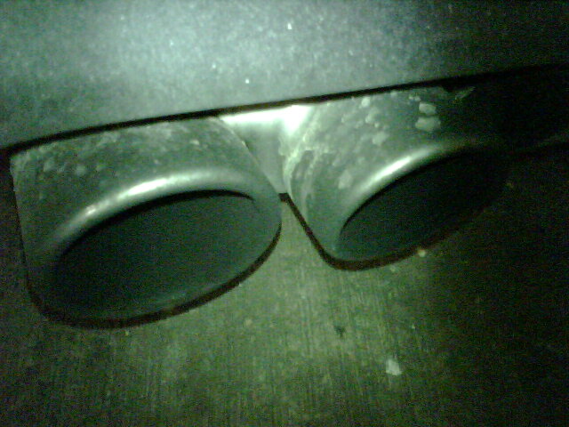

My car has 34k miles. 06 Model.
I had an oil change a 1000 miles ago. But Sunday i had to put a quarter of oil as the gauge was blinking. Now, my left exhaust tip is very dark compared to the right one. It's almost black.
I read on another board that this is a known problem with early 997s that might result in an engine change?
Any ideas ?
Thanks

If only 1 side is sooted up that usually means a cylinder issue like a cylinder ring or a valvetrain issue with possibly a sensor on that side.

I stopped by my dealer yesterday and they didnt seem too worried about it. Couldnt explain why only one side was sooted up..
They put me on the Oil Consumption test...

I had this issue with my 05, the cylinders were "not round" as dicovered after a compression test of the cylinders, 2 of the 6 were slightly oval, my engine was switched out. I'd go to another dealer, that's not normal. Porsche has a good reputation of doing the right thing, but not all dealers do. Good luck. If you look at the PCA site, they have my right up under engine in the mechanical forum area.

A bit more recent - engine replacement as well :-(
https://www.6speedonline.com/forums/...haust-tip.html
