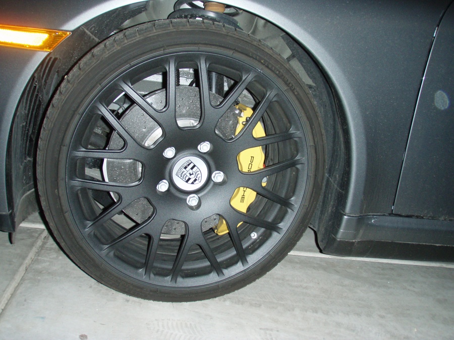

I love my PCCB's and have no regrets about the extra cost to spec them. Amazing brake feel, so solid and easy to modulate. In combination with my forged AMT's, I am saving about 14 lbs per front corner and about 12 lbs per rear corner. Road feel is improved and ride is noticeably improved.
I have never experienced brake noise when hot or cold or ever seen any dusting even after a very spirited drive through mountain roads.
Pretty close to a go-kart feel.
No problem driving in sport mode unless the road surface has chunks missing.
Is the improvement worth the (monumental) cost? Only you can answer that. For me, I could not be happier and would make the same choice again.
