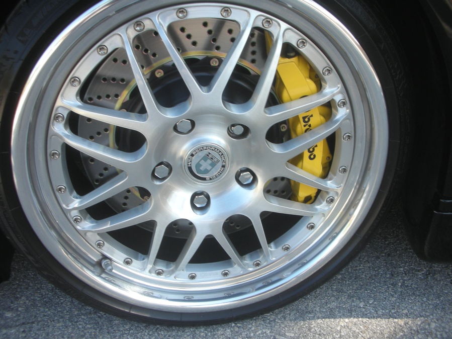

I had PCCB's in my 2005 launch car . I loved them and they had no brake dust and worked very well . I felt that they were not worth 8K to buy though and in my 2007 C2S I did not get nor did I get them on my Turbo . The steel Porsche brakes are outstanding and the price is quite good compared to the PCCB .
When I upgraded to 700 Hp I felt the steel brakes needed an upgrade and I could have selected the PCCB . I didn;t . Instead I went with the Brembo and comparing ALL the brakes I like these the best. Installed it cost nearly the equal as the PCCB (a little less) but I feel great response and reduced fade . Someone on the 997tt forum asked (paraphrasing) " what difference does it make ro slow down a car ?" My reply was that if a car can accelerate so fast it need an equal quick response in stopping .
PCCB's are yoir best brakes out of the box .
Aftermarket makes better though IMO .
Steel are great and free .
Pic of the Brembo.
You can't go wrong with any.
