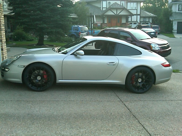

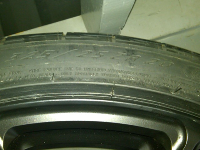

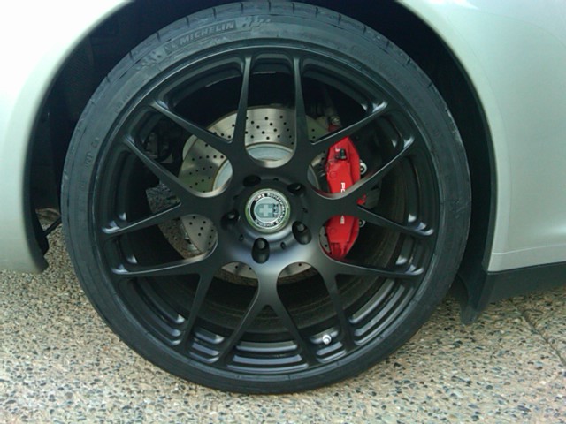

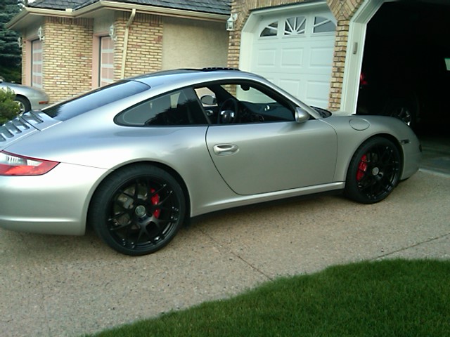

I just put these on on saturday.
20" HRE P40's on my C4S, yes I am running 245/325.
I think optimally I would need a 3/4" drop, doubt I will have any rubbing issues.
Will post up better pics soon, these were taken with my bberry.
Forgot off the top of my head but I know with this sizing I am withing 1% of stock 19 sizing.
