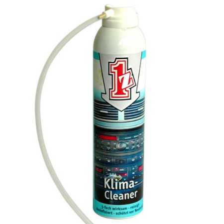

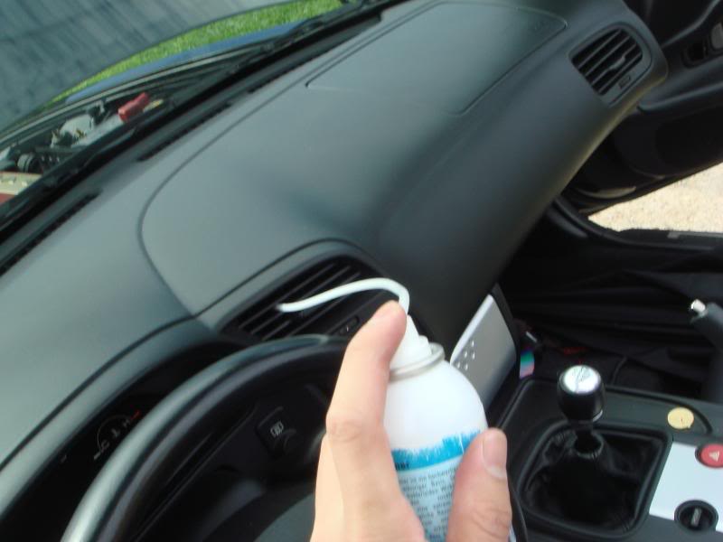

I had a similar problem. Try Einszett Klima Air. It's a can of foam with a long tube that you empty into your AC vent. Wait 30 min and voila. It worked very well for me. Only $15.. worth a try!

The active ingredient in Lysol and other odor neutralizers is ethanol. The ethanol kills bacteria and neutralizes the acids lfet by them. The best way to bring Lysol or a similar product into your A/C system is to find the intake for the recirculation mode ( generally down in footwell area near the console on most cars) and spray the ethanol containing product into the intake while the system is set on recirc. You propbably only need to do this for 5 seconds. Aside from that I would generally use the A/c in normal mode ( not recirec) and shut it down ( fresh air only) for the last minute or two of driving. Parking the car outside does not help.
that cool, i am going to order some, just in case i start to get a smell, which i dont have now, but i remember my 996 had one...
