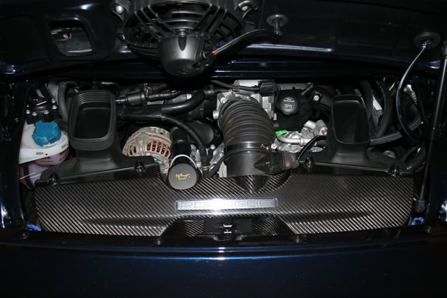

Very well said. the best intake is the X51. two big filters. more surface area is good.
Yeah, but idea of cutting new hole for second intake in my car scares me.
