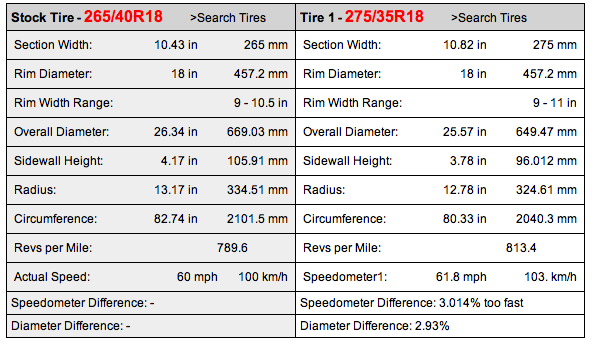

will 245/35/18 & 275/35-18 fit on my stock wheels?
Im looking to get a set of the hoosier R6's in 245/35-18 and 275/35-18 for my stock wheels to run AutoX at this weekend but my stock tires were 235/40-18 and 265/40-18 (from tirerack.com) so will these R6's fit? and is it better to go bigger then OEM or stretch smaller tires then OEM?

Originally Posted by nugent_crai
fongool! what to do?!?!? A6 i guess... will those dimensions fit?
I would say you could get away from them, the short tire height will give you a little quicker acceleration, with will be good for Autocrossing.
