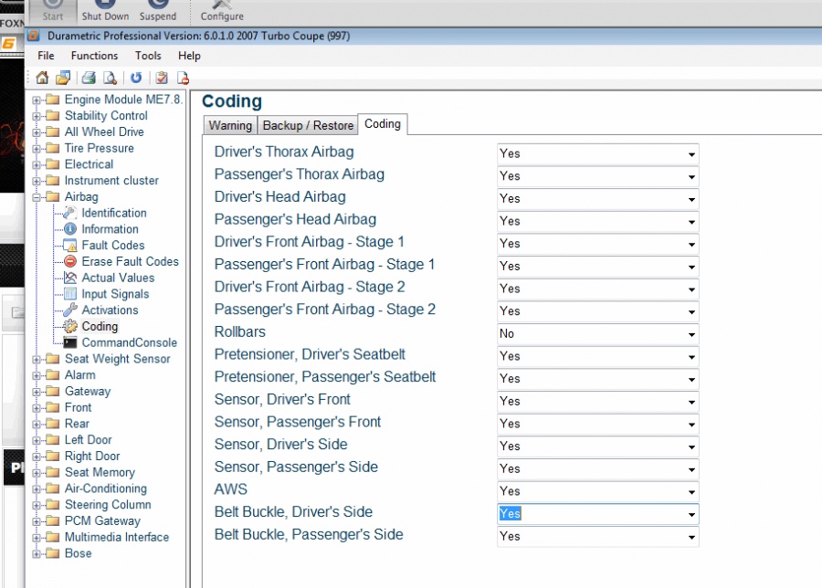

Knowing now that this is an adjustable feature I wonder - can anybody with pro durametric cable reach to this setting?

PIWIS and Durametric 6.0 can both access the programming for the seats. Any part of the car that has a control unit has coding programmed in flash RAM that can be accessed. So to answer the OP's question, yes you can shut off the chime, and you don't need to go to the dealer to do it. If you are in the Wisconsin area some time, I'd be happy to do it for you.

Hey bbywu, I tried to do that with the professional durametric I have and it didnt seem to work, it said the control modules I have are not supported or something of that nature....my car is a 2008... Any input would be appreciated.

The Durametric Professional kit fixes it. Steep price though.
