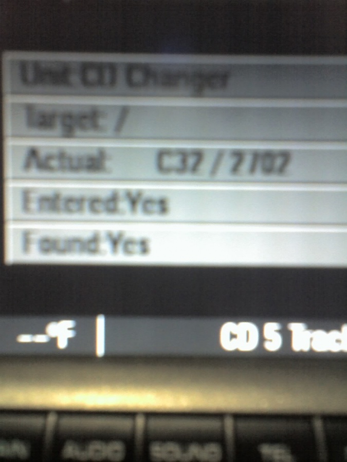

Warning icon next the cd changer.
Hi all,
The install went well. The Porsche Dealership enabled the CD changer, now I have a warning icon next to the CD changer on the screen that pop up when I press trip and main buttons on the PCM. Check marks are next to amplifier, PCM, and system software. Clicking on the CD changer, I get a screen that shows Unit CD Changer. The Target field is blank. The actual field shows the C32/2702. Entered: Yes; Found: Yes. See attached .jpg. (sorry for blurriness).
I had the dealership, disable and re-enable the cd changer. I've updated the firmware to 2.22. I've reset the aux module. I've rebooted the PCM, but the warning icon persists. I assume that is because the Porsche PCM just doesn't recognize an aftermarket part, and there is not a problem with my installation. Can anyone confirm or deny? Otherwise, the unit is functioning perfectly.
Thanks.

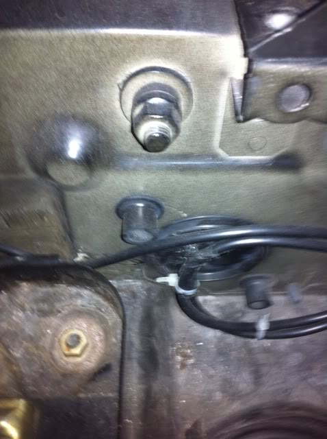

I used the grommet on the passenger side. I removed the battery and ran the cable under the front of the battery tray and then through the grommet on the driver side
Picture is looking forward the battery tray to the left.

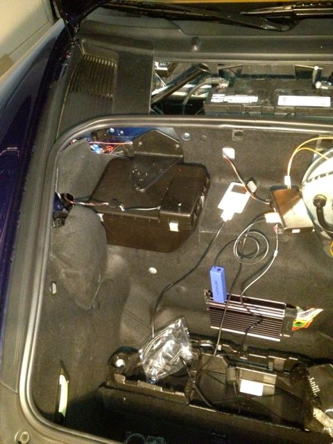

Eric, I had the same thought, but that specific grommet is behind a rectangular box in my car that is not easy to remove. Here is the picture of my trunk space, and you can see that the position where the grommet is that you point to is right behind the box. I tried to take the box out with the two torx screws so that I could get to the grommet on the trunk side, but could not easily get it out. Not knowing what the box is, I did not want to force it. Anybody know what this box is? I have an 06 997 C2S with sport chrono and PASM.

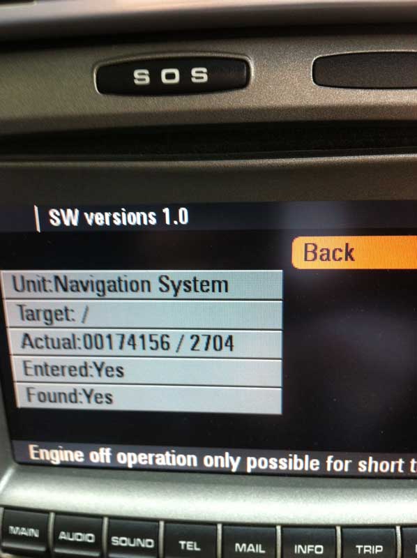

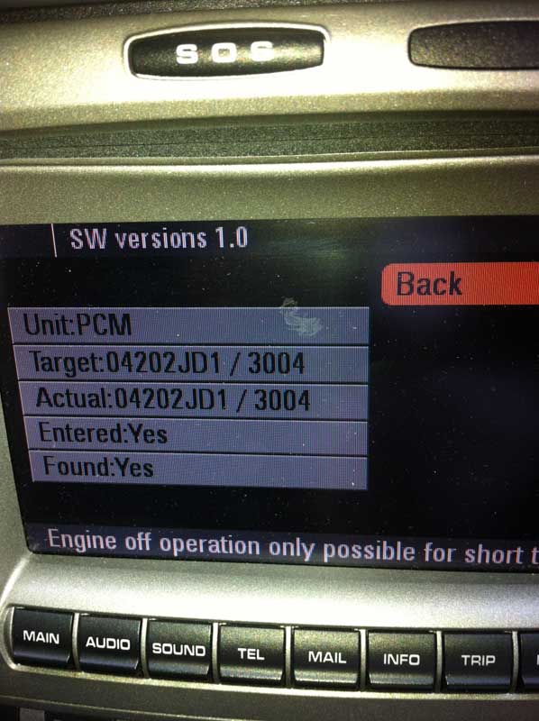

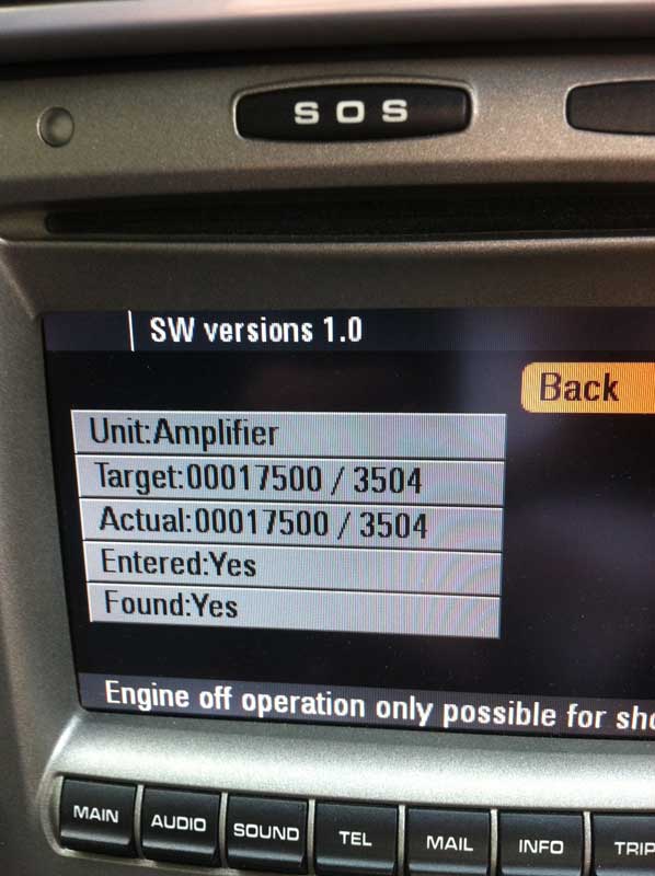

Gateway 500S BT install preperation
Hi there!
I'm looking to install the Dension Gateway 500S, but I have some questions. My Porsche is a 997 2005 Mk1. I think I have a PCM 2.1 DVD, because I have the DVD navigation.
1. I have the Porsche phone/sim module, do I need to install another mic?
2. I've uploaded software versions shots, do I need to upgrade the software/firmware before hand?
3. When I press the 'CD' button twice the HUD says 'no CD changer' so do I need to get the CD Changer enabled by Porsche?
Any help would be very welcome!
