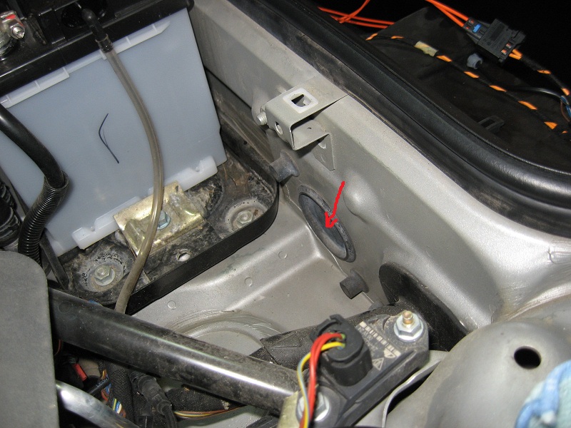

The easiest way to go from the trunk to the battery compartment is via the grommet behind the carbon canister bracket and CD changer:
