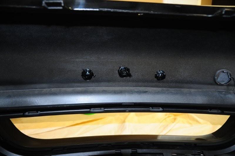

This pic is taken from "justatoy's" thread on his magnetic license plate frame install. You can see that the lower opening on the GT3 bumper cover has a plastic retaining frame. If you buy the areokit bumper cover this area has a plastic cover instead of an opening. To run a center radiator on the aerokit bumper you will need to swap out the cover for the retaining frame which is easy to do.
