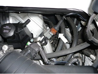

Or, you can just unplug the 12 v power to the solenoid
( that's the orange plug just above the filter box) but then it will ALWAYS be loud. And I mean LOUD .Lol )

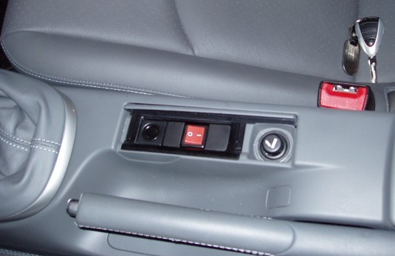

I installed a 2 way switch into my ashtray ( see photo)
that way I can cotrol the PSE from inside the car, anyway I like .
In one position , everything works per factory setting.
In the other,the switch disconnects the 12 v to the solenoid and the PSE is always on )
JCS ....What wire on the orange plug did you connect the switch to? I like your idea...........Thanks

You can get to the control wiring by removing the aluminum cover
behind the passenger seat .
The carpet cover can be removed by just lifting it out ( be carful , the backing is molded ridgid foam . Start by gently pulling up in the middle of the car and then slide each side out from under the side panels )
The 12 v power wire to the solenoid is red/purple and the ground wire is
lt. green .
They leave into the engine compartment in the upper left corner (looking toward the rear of the car )
( you can also splice into the wire directly at the solenoid , but then you need to figure out how to get the wires from the engine compartment back to the switch inside the car )
I cut the 12 v wire and spliced a wire into it , which then was routed to the center console .
I used a 2 way switch . In one position , the circuit is closed and everything works per factory . In the other, the circuit is open , no power goes to the solenoid and the PSE is always on.

Ok - switch & wire from Radio Shack. What did you use to make the switch mount? Looks like a piece of black plastic - source? Thanks.
