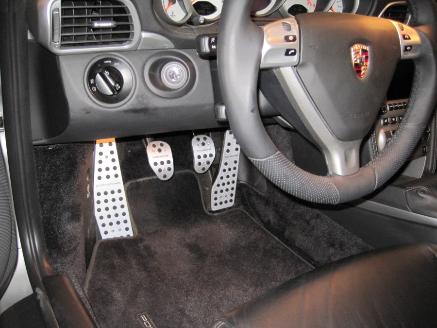

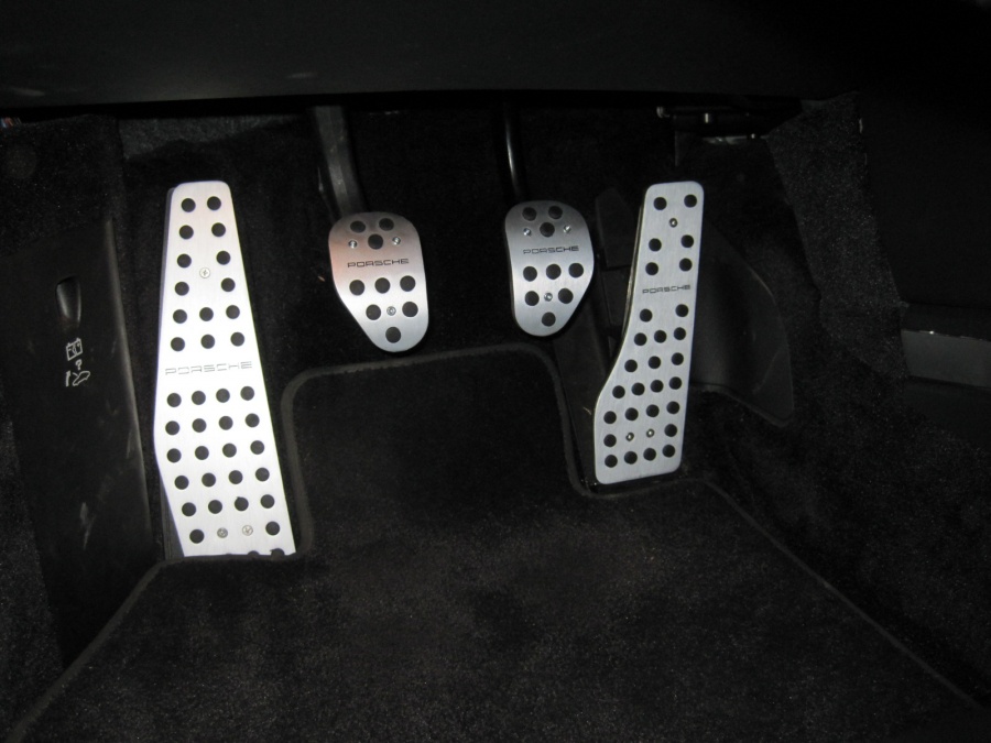

Attached are some pics of my new pedal covers. Bot them on Ebay for $90 total. They are really nice quality aluminum with a rubber pad on the back that comes through the aluminum holes. Nice "Porsche" engraving also. Installing was tough. You need to do the brake pedal first (thanks to others on this site that suggested that). Drill the bottom hole first on the brake, slightly offset to the left and as low as possible. Getting my big fingers behind the brake pedal to put on the washer and the nut was very tricky. Used a mirror to help me. I also used Loctite thread lock on the threads to make sure they don't loosen over time (you can buy at Lowes or Home Depot). Note, the brake pedal and clutch have covers that need to come off...they are rubber tabbed covers. Weird that the clutch pedal is plastic...would have thought Porsche would have made that metal...hmmm. Anyway, do the brake first. I then used double face tape to position the clutch cover. Got it exactly level and straight to the brake, then I drilled. Careful, the pedal is plastic. The dead pedal and gas were easy and plastic also...hmmm.. Used double face tape again to get exact position, then drilled a "small" pilot hole. These use a wood screw with no nut...so careful not to strip the plastic when screwing in. And that's it. Took me about 1.5 hours to get them really straight. Note, the new steering wheel with directions is on a previous post of mine.
...Marc

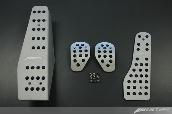

I just ordered these, on sale from AWE for $129. Top quality is AWE's business, so I look forward to installing them.
One question: not sure which way the break and clutch pedals are supposed to go. I think maybe you've got them reversed? I'd love to know before I install mine. Here's a pic from AWE, attached.
CATTMAN

But look at the picture of them INSTALLED at the AWE site:

I spoke with AWE, and they said to install them like the install pic, so all is well. Mine should arrive in a few days, and I'll report on any shoe slippage issues.
