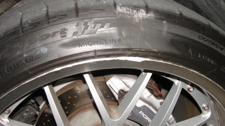

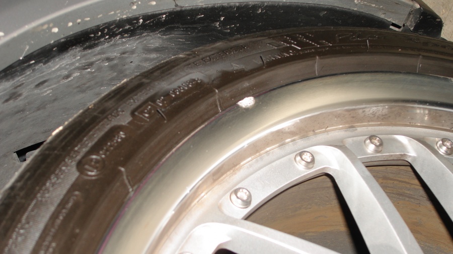

While on my way to work this morning, I accidently missed my exit and had to turn around. Instead of making a U-turn in heavy morning traffic, I decided to turn into a local street and go around the block in order to get back on the main street that I was on. While en route to the main street (a one way street) a semi-truck decided to make a left off of the main street and head towards me. Due to the Semi's wide turns, I had no choice but to drive onto the sidewalk. It was either that or have the truck completely damage the side of my car. Hearing the two thumps as I went up the sidewalk gave me the impression that I had damaged the side skirt of the car as well. Thankfully it was just the front and rear wheels.
I am not too familiar with wheel damage and therefore do not know if these could be repaired or not. In my opinion and from the looks of it, I may have to bite the bullet and purchase a new pair. If anyone could provide me with some insight in regards to this, or if they know of a reputable wheel repair shop in Miami, I'd greatly appreciate it.
Below are a couple of pics of the damage. Please excuse the poor quality of the camera and the dirty wheels.

The damage shown in the photos can be readily repaired. They weld in new material, smooth it out and repaint the wheel. Typical price is $150 to $200 each. I have had worse defects fixed for $150.
Low profile wheels and tires, unfortunately, are highly subject to road hazards. Tire and/or wheel replacement is often necessary. As long as the sidewall of the tire is not gouged much, it will be hidden by tire black. Tires don't last long, anyway. If the sidewall is really hacked, however, replace the tire, it is not safe at high speed.

I can only really echo what others have already said, but +1 on all the above. The damage looks minimal. A good quality wheel repair shop should EASILY be able to correct that damage. I would expect to pay probably between $150-$250 in my experience for a total repair such as yours. Just please keep in mind that it will require, as someone said, the removal of the tire from the wheel and then reinstallation.
Both are going to need material added back to the wheel and smoothed out, so it will not be a in and out process. Hopefully you have some stock wheels you can slap on temporarily while these are repaired?

That kind of damage can definitely be fixed, BUT there are certainly different qualities of repair. I would ask Larry for a contact at Champion or his other big P car dealer in Florida for a good contact. There are plenty of lousy repair shops. Your wheels look like 3 piece wheels with polished lips. Not sure how you really repair those. You may need to have the outer barrel replaced. This will be a $500 event per wheel, but the wheels will be perfect. The other way is to have metal added and smoothed out, as some have suggested. This will certainly work, BUT they will simply paint the edge of the wheel. They can't add metal and then polish the edge of the wheel, I've been told it's not possible. I had a set of the BMW 19" factory forged polished wheels and only noticed later that the edges of two of them were actually painted! Anyway, the paint repair can be done, but you will definitely be able to notice it - especially if you have highly polished rims.
The consolation for you is that with multi piece wheels, you don't need to replace the whole wheel. It still isn't cheap though. Good luck.

I would just contact a good associate at a dealership - Champion(?) They would certainly know where to get a good repair. But, as I said, if they are polished lips, they can't be properly repaired and will need to be replaced.
