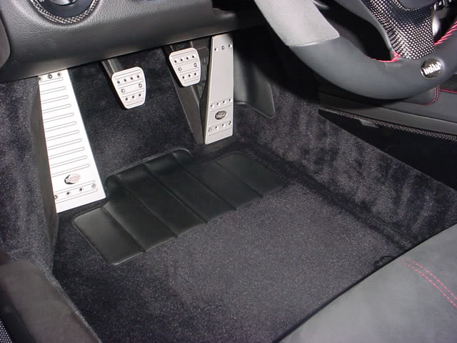

OK, here we go. Probably take out the floor mat... not necessary I guess, but I didn't want anything in my way at all because we're removing the accelerator pedal assembly.
EDIT: You may not have to remove the pedal assembly (I actually don't know what Sprint Booster themselves recommend). If you want to try to install the Booster without doing this, skip down to where I describe how the connector works. However, I took out the assembly for superior access.

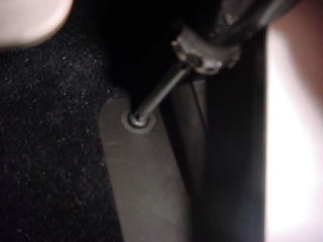

Grab a phillips screwdriver and remove the 1 screw holding the assembly in.

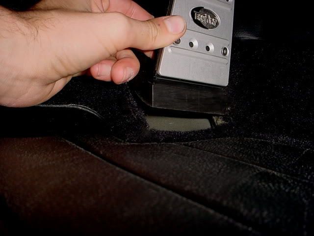

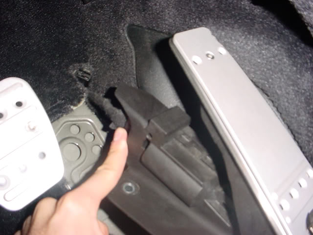

Now pull up on the entire assembly (doesn't need a lot of force) and it will dislodge from the floorpan so you can pull it away somewhat for access to the plug in back.

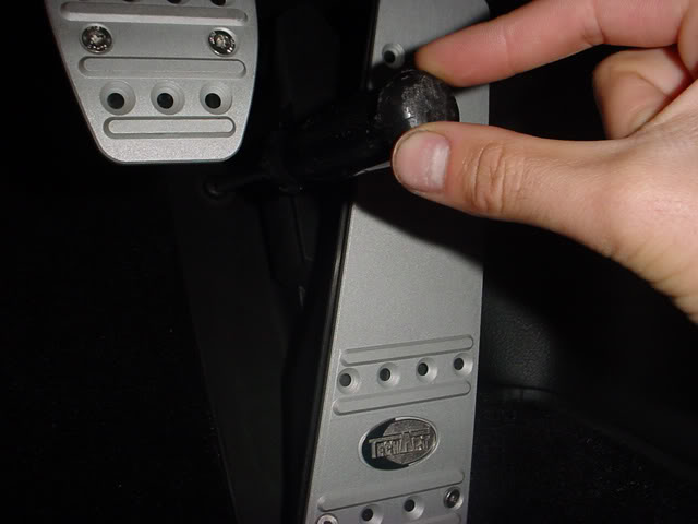

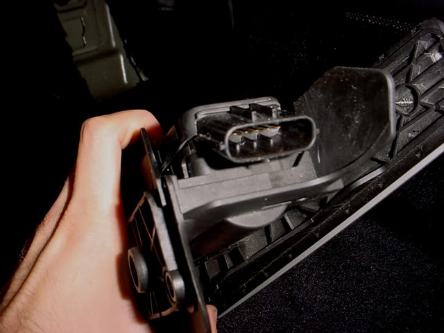

Now we have to remove the connector. My index finger is pointing to it in this pic:
You have to depress the gray piece in order to remove the connector. This will take some force -- really press down hard! In the following pic, the connector has already been depressed and I added a red arrow to signify that.

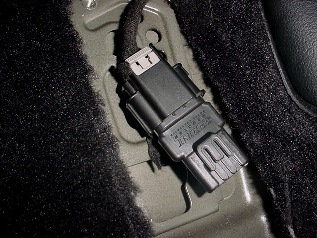

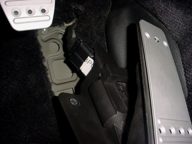

Install the sprint booster into the connector that is now hanging on the floor. This, again, will take some force, and once you have it all the way in, the gray piece will snap out as seen in this pic.

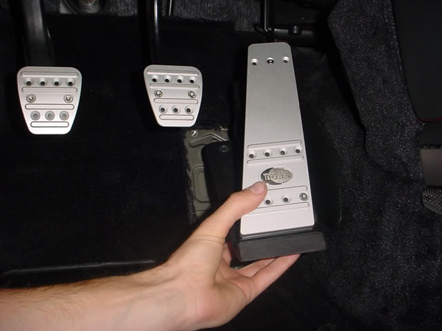

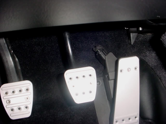

Slide the pedal assembly back into place on the floorpan and reinstall the phillips screw. Here's a final pic showing the sprint booster in its new home!
I took a short drive after the install and it really does increase throttle response! The best way I can put it is that it decreases the lag that the car always had when you stepped on the pedal -- which, I'll admit, was still nothing compared to the lag on my Lotus Elise (also drive-by-wire). I'm definitely going to have to get one for that car now!
