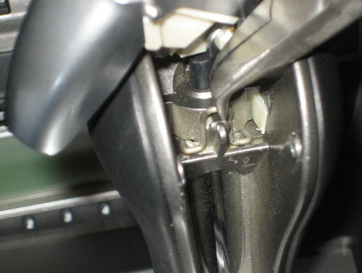

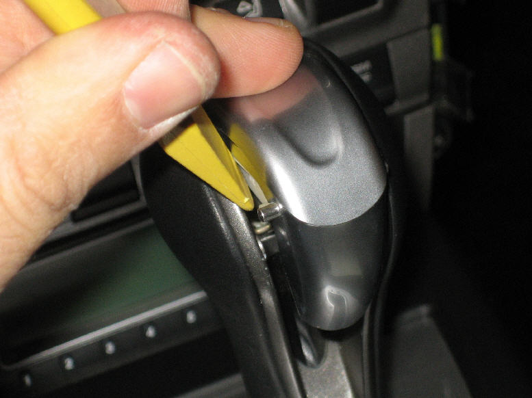

I do not know if that't the official procedure, but on my 2007 I removed it according to the attached photos. Nothing broke (so far).
I used a trim removal wedge and carefully pushed out the upper release button. The button is still attached to the **** with a spring. Could be removed too, but it's not necessary.
The **** is fixed to the lever with a clip. Remove that clip and you can pull off the **** from the lever.
Good luck.

Here you go:
http://www.renntech.org/forums/index...7&#entry108867
You'll see the step referencing the "spring lock" does not have a picture and was the most confusing for me, but you'll see the upside down u-shaped metal pin that you'll push in.

oops pull out (as Luzy_V8 shows)
