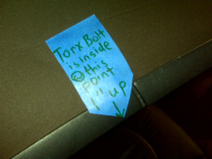

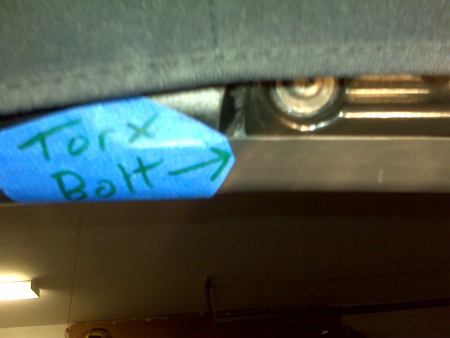

Can you post a pic or description of which bolts you're talking about?

I've had several "PM's" requesting pictures of the Torx (T-30). So here they are:
