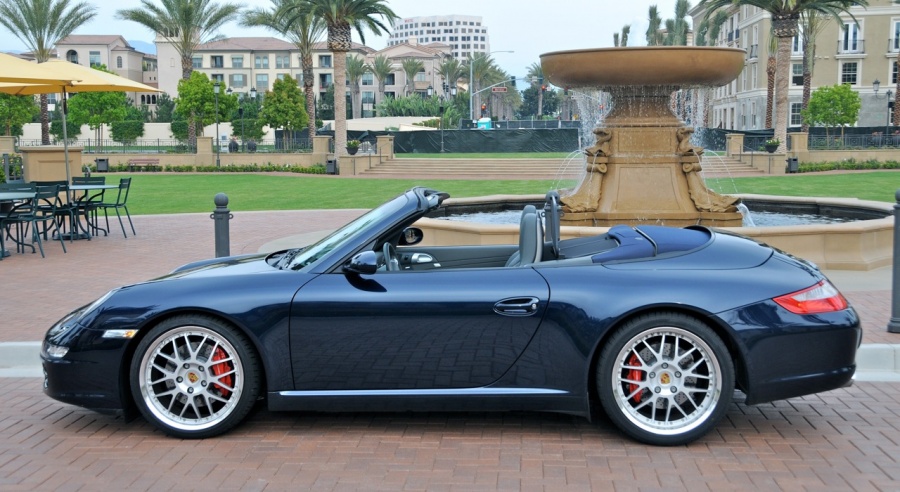

The drop looks great, especially with those wheels. That's a great looking cab.Originally Posted by keninirvine
I concur. I had my set installed a week ago at Hergesheimers in OC. I had the alignment set up for ROW-Performance, with about -3/4 degree camber in front and -1.5 in rear. THe car is lowered about 1/2 to 3/4". I love the look, love the handling, and find the ride very comfortable. While a little stiffer, it still feels compliant, and is less jiggly in sport mode than before. I am totally happy with this mod so far. I kept my cost down somewhat by finding a second hand set with 5000 miles from another member who went back to stock. I figured the significant savings was worth giving up the warranty for.

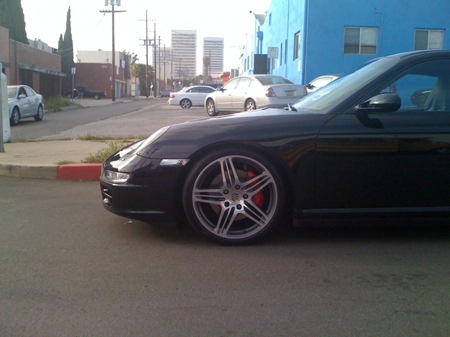

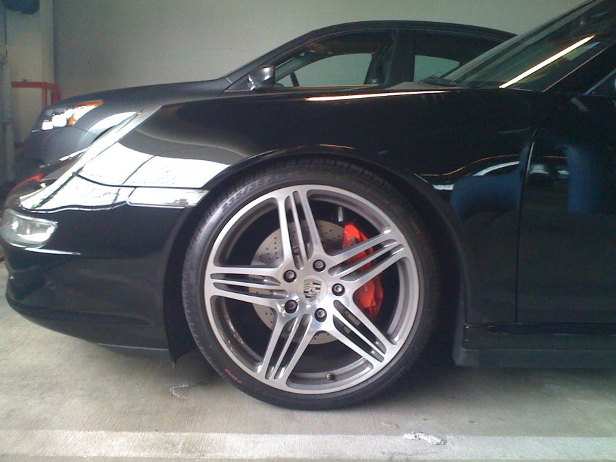

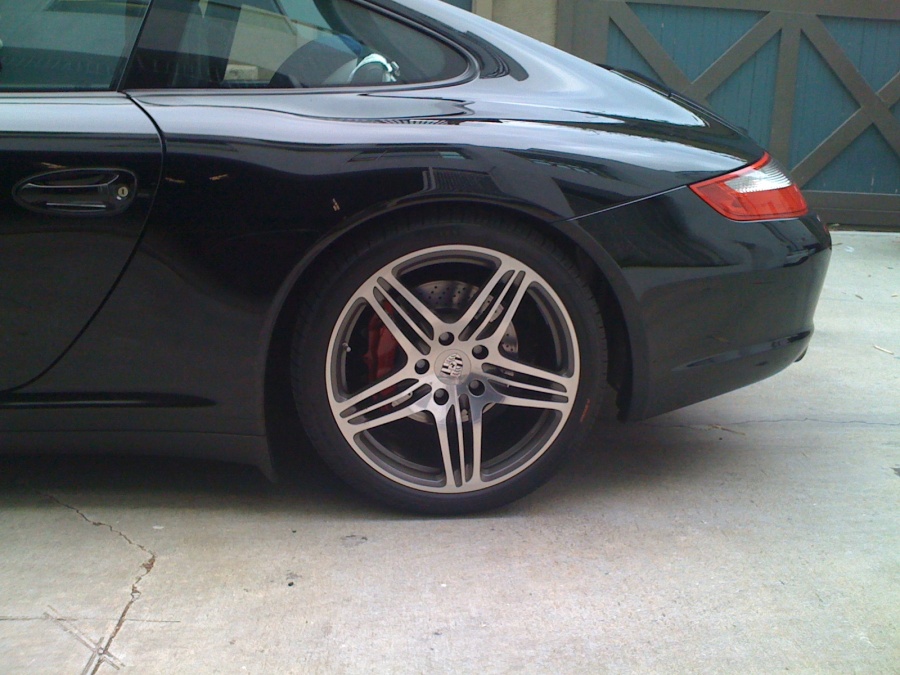

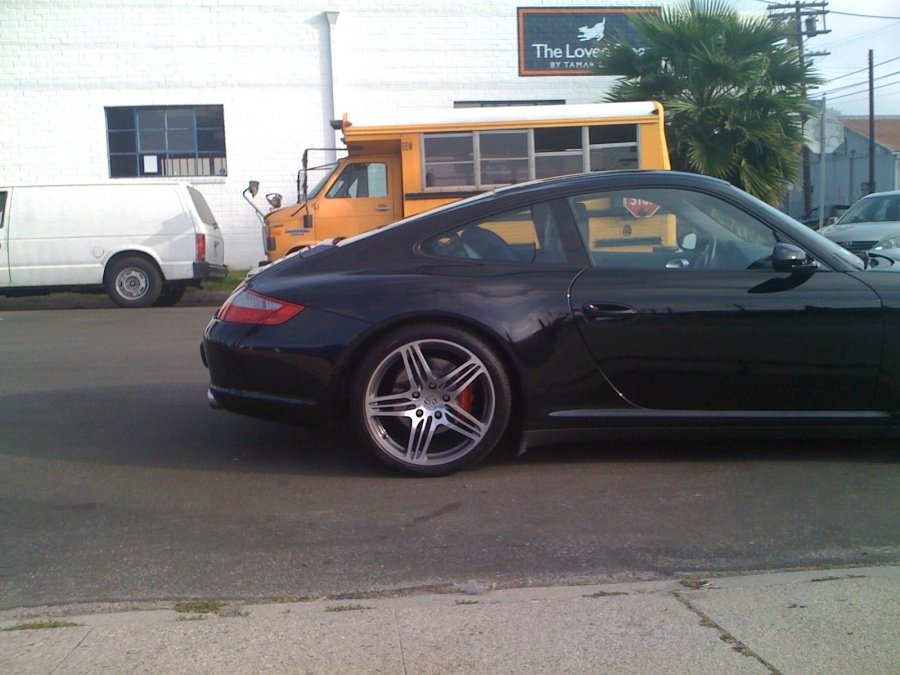

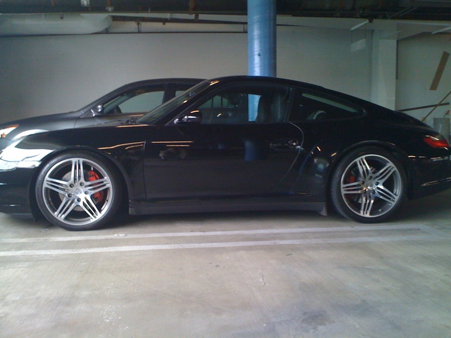

Nice height. I assume you lowered it about an inch or slightly more? What are the measurements from road to top of wheel well openings? I'm guessing 25 1/2" front and 26 1/2" rear.Originally Posted by dk10438
sorry for the crappy picsAttachment 119434
Attachment 119432
Attachment 119431
Attachment 119430
Attachment 119433

25 7/8Originally Posted by keninirvine
nice height. I assume you lowered it about an inch or slightly more? What are the measurements from road to top of wheel well openings? I'm guessing 25 1/2" front and 26 1/2" rear.
26 5/8
