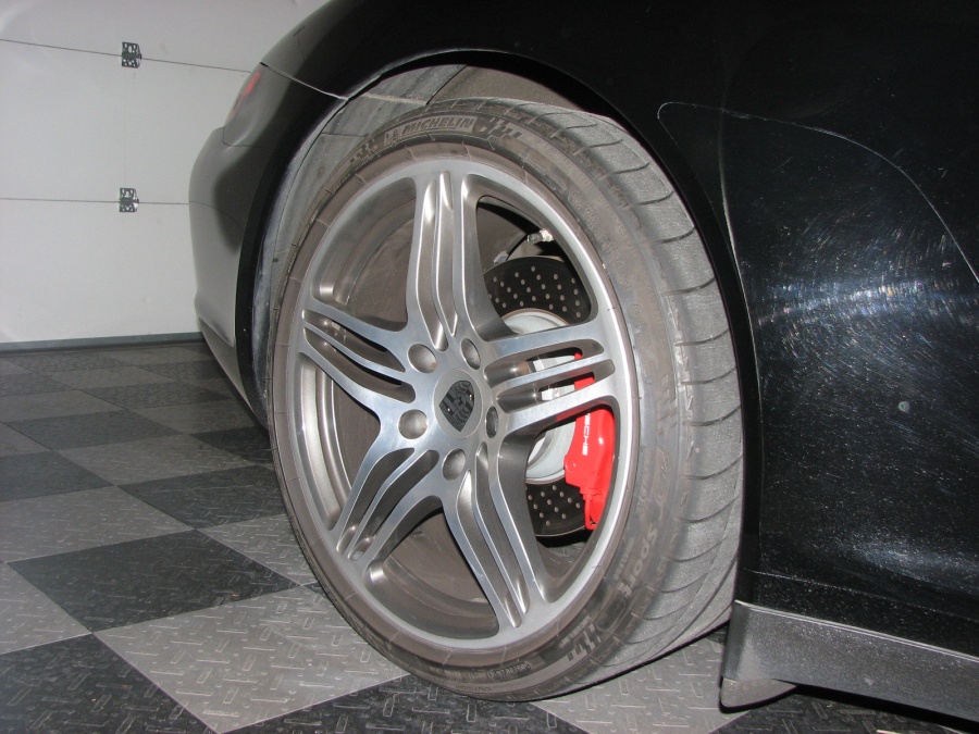

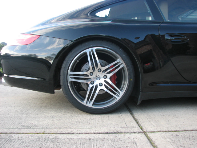

First of all, just wanted to say the Bilstein Damp's completely alters the character of the suspension in a good way....car was aligned and new camber/toe set right after install(I know I should have waited to do this).
1. Road Feel--the "feel" of the car is much tighter now...kinda a heavy feeling without losing the feel for the road...you can now better tell whether your running over a pebble vs a spider......the front end "floaty" sensation is completely gone now...feels very planted now...the tight steering feel was also improved by new 5mm front spacer and 15mm rear spacers...spacers provide better looks but also provides better feel and lateral grip sensation imho by pushing tires/wheels out.
2. Turn In- this is much more responsive now...there is no more lag between steering wheel turn and the car changing directions now...this lag seems to have resolved now...I have the toe set at 0 because I didnt want the twitchiness that toe out can create even if this improves faster turn in...when the car squats with throttle, the toe will turn out slightly on its own and unless you do mostly track driving, neutral toe made better sense to me....camber is set -1.22/1.19 front and -1.6 for rears....did not get it cornered balanced.
3. Bump/Stiffness-some people say with damps its about 20-30% stiffer than PASM on/off...I think 50% at a minimum is more like it...there is no body roll now!...the car is stiff now no way around it...this is the sacrifice you have to be willing to live with for better handling...only place where I would use PASM sport mode is on the track from now on.

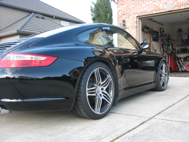

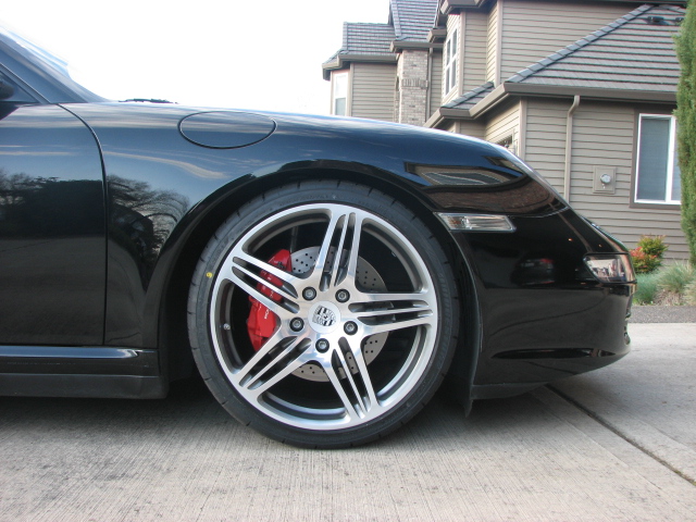

4. Ride Height-the car has been dropped 1 in or 25mm at all four corners...I did poor mans measurement from top of wheel well to ground and Im now 25 1/2 front and 26 1/2 in rear...you can definitely feel you are riding closer to the ground now...the look of the car is completely different now...much much better in looks department imho...also, gotta be careful when pulling into the driveway now as I have scraped several times now...cant just pull in without thinking about it anymore.
5. Acceleration??--sounds crazy but car feels faster now...while this prob couldnt be true, I think it has to do with the car being stiffer and nose not lifting and wasting energy and time before accelerating...this is the best explanation I can think of...but car feels abit faster and more responsive with throttle.
Drove some twisties and I can definitely take these corners faster and with more confidence now...car just feels rock solid around corners and begs to be driven harder imo...no roll, no front end diving with braking, no front end lift with acceleration....btw, I got new Bridgestone RE-11's also...these tires are really grippy.

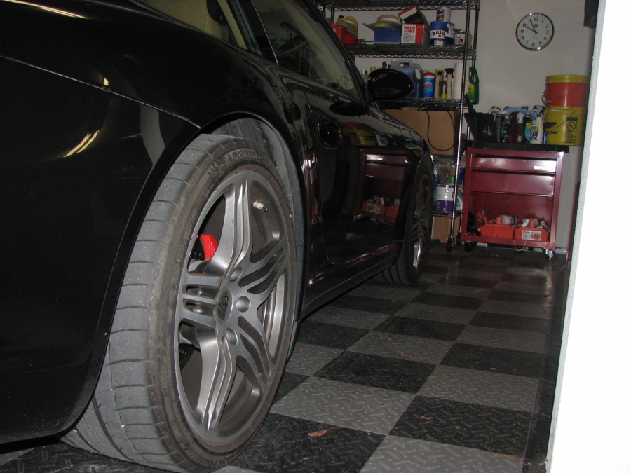

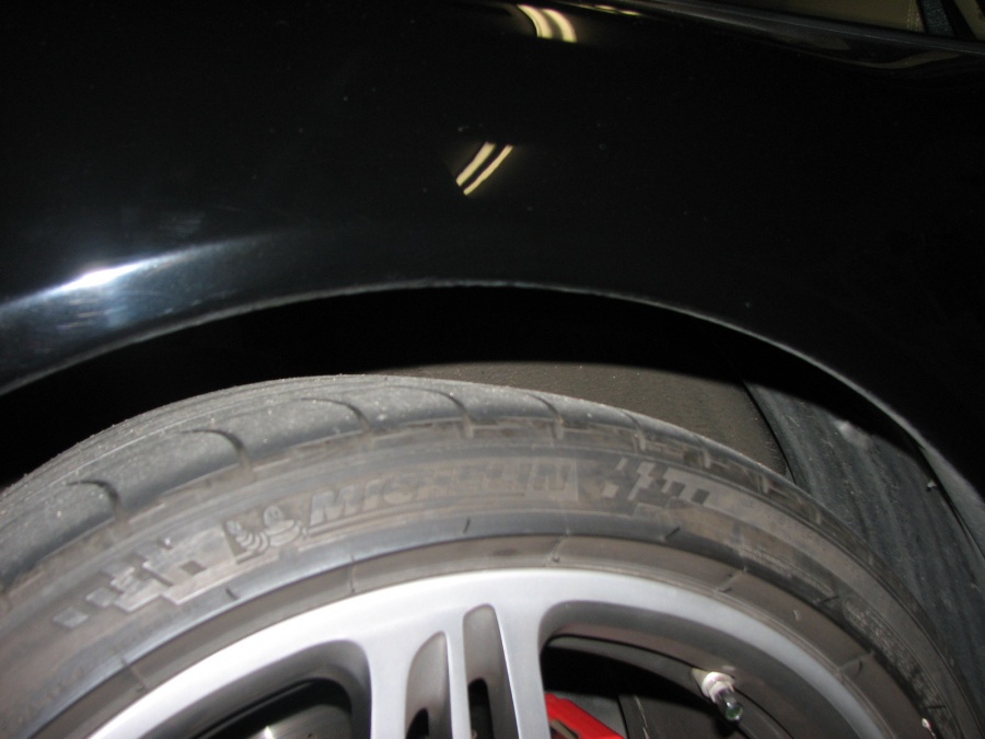

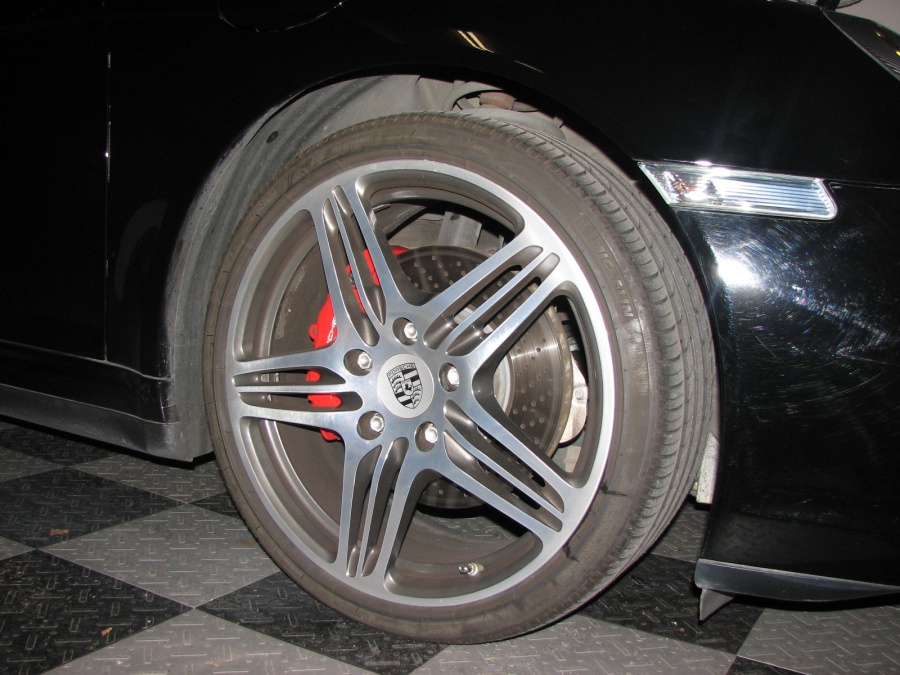

Here are some before pics:
Attachment 120867
Attachment 120865
Attachment 120866

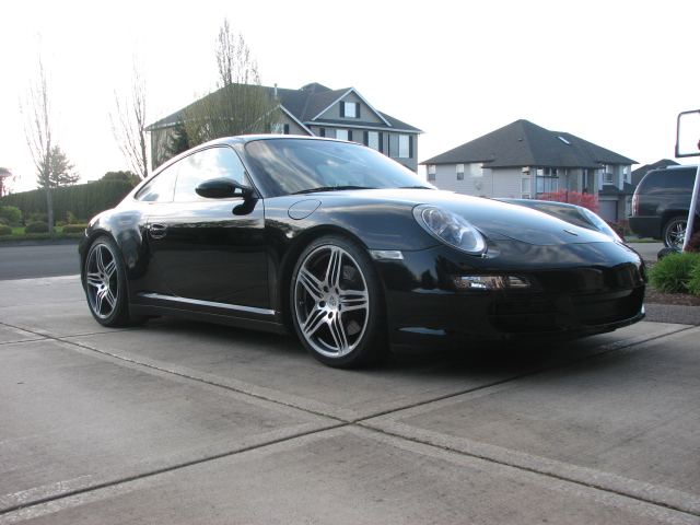

After Pics:

Bad link for "before " pics...here are the pre-Damp pics:
