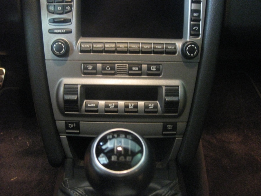

Anyone else with A/C Unit buttons chipping-off issue

Holy cow. You have to get a whole new unit? Thankfully I asked the dealership to replace my flaking unit before the warranty expired.

The oil causes it to flake. What a load of crap. The material chosen what just crap. Just way too fragile for to use on anything thats touched.

I have seen this problem with many cars. The oils from one's hands and in particular hands that have residual hand cream, sun tan lotion, etc, will destroy painted surfaces. It is too bad that whoever designed the unit did not specify black plastic for the buttons rather than coated plastic.

Bought preowned my06 997s week later noticed problem with the climate control *****. Needless to say had to remove the flaking paint. Now they are down to bare white plastic.

I had the same problem and quickly found out that the buttons are not replaceable. The whole unit has to be replaced. So, I taped everything off and spray painted the buttons with Plasti Dip http://www.plastidip.com/home_solutions/Plasti_Dip
fom Home Depot. It is a rubberized type paint and it worked very well. The only down side is that you will no longer have the fan graphic and white lettering on the buttons. But it looks a lot better than the chipped mess IMO.

You should be able to have it masked off and painted while in the car. Then have the lever pushed upward and the bottom could be painted and the reverse can be done for the top. I would do it since it would be unsightly for me.
