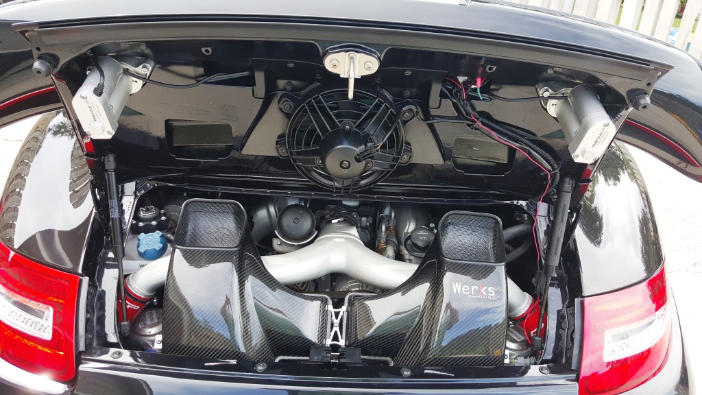

Unfortunately I don't know if the 997.1 deck lid changes things either. But as to the airbox: If you want to measure the width of your airbox you can compare it to the ones from mine below. I'll discuss this more below. (The gentlemen that bought the car will be here on Monday to pick it up so I was still able to take photos).
2). Also if I do need a new airbox I only found the EVOMS intake for the 997.1 ( http://www.evoms.com/category_s/2028.htm) and nothing for the 997.2 (non-S). Which EVOMS would be appropriate for me? Or if I go Fabspeed, will it fit without moving things around? Someone else mentioned they still had to cut pieces.
The Fabspeed dual cone intake shown in my thread fits easily with no cutting of anything. It is pretty similar to the carbon ones they currently sell. I don't know about other intake brands.

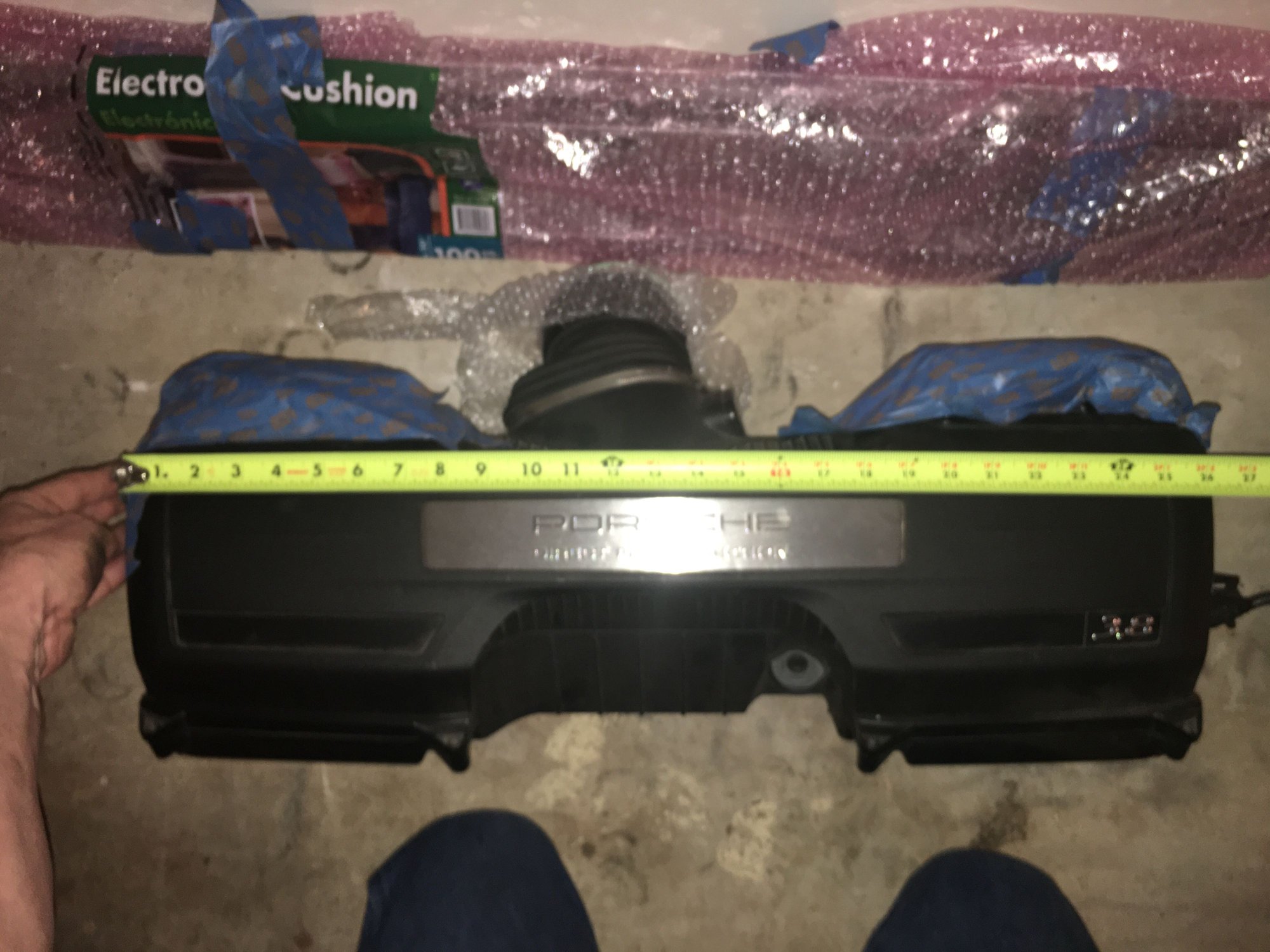

The airbox from my S measures about 26.25" across at the point where the hydraulics descend, while the gap between the hydraulics is maybe a hair under 26". Maybe the non-S airbox is narrower. I'm including photos that show where I measured below. If your airbox is narrower at that position then you might have a fit like the other Rennlister you referenced. Also, remember that the airbox may wiggle around a bit under engine load due to the rubber grommets used to mount it, so I would be reluctant to have them touch the hydraulics (not sure about the electric motor approach Petza mentioned). I would think you would want your airbox to be around 25" at the point where I measured mine in the photos below.
Measure across here above the aluminum plaque.
I get about 26.25" there at the upper edge, getting even another ¼" wider farther back (you can kind of see that in the photo), which when added on both sides means the bottom of the airbox is about 26.75".
With the other end of the tape held against the inner edge of the left hydraulic cylinder, here is the reading from the right side. Maybe a hair under 26".
I get about 25.25" there at the upper edge, getting even another ¼" wider farther back (you can kind of see that in the photo), which when added on both sides means the bottom of the airbox is about 26.75".
Petza and Stormrune, you are both gentlemen and scholars thank you.
My 997.2 air box is also 26.75. The only possible thing that can make a difference is somewhere I read the 997.1 air box sits a little more towards the rear of the car. And another thread with a 997.1 TT wing on a 997.2 non-TT car mentioned that the snorkels were the only thing that needed modification. Perhaps the position / location of the 997.2 air box allow room for the hydraulics?
One thing I did not come across that may work is if it's possible to replace the 997.2 airbox with a 997 TT airbox? And is there a difference between the 997.1/.2 airbox?
Can anyone kindly advise on this? Is the fitament compatible?

You will definitely need an aftermarket airbox if you decide to go with the better electric Eram setup. The motor with actuator is a larger footprint vs the hydraulic cylinders

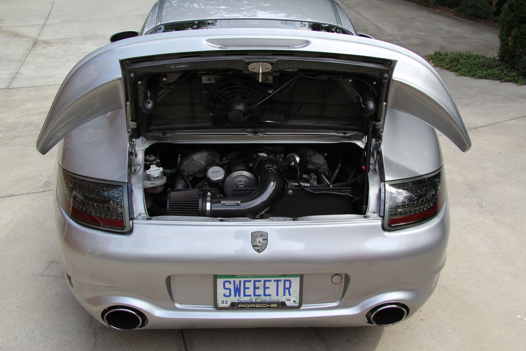

997.2 C4 with a 997.1TT decklid/wing.
Do you know any good body shops where they can do something like post #26 from this thread? https://www.6speedonline.com/forums/997/208788-turbo-wing-997-2-c2s-2.html#post3515708
He installed a Turbo wing and the snorkels on the turbo wing are towards the rear end, so the body shop custom meshed the rear side of the plastic (picture attached as 26.jpg).
Post #26 with clean look
when i got mine installed, my body shop did a hack job and basically cut an opening to match the snorkels.
What's worse, is they covered the original openings (towards front of car) with some plastic parts and glue. The left side is still glued
But the right side is coming off;
I can probably buy the top half of that air box brand new, and send it over to a shop to mimic the job from that user on post #26.
In the meantime, wondering if i should just take off that piece that's falling now...
