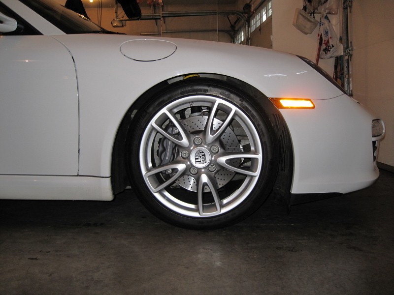

Originally Posted by akim47
. the bilsteins seem to weapon of choice... kw v3's are good, but i dont think they have product out for the 997.2 yet (i may be wrong)...
I agree. If you're looking at coilovers, the Bilstein PSS-Damtronic coilover is the way to go, simply because it retains the use of the factory PASM system in the car to adjust the dampening.
KW does make a V3 coilover for the 997.2, however, it requires disabling the factory PASM system, as the adjustment to compression/rebound are made on the shocks themselves, manually.

Originally Posted by jo2e6y
First of all... how did you get the LED and headlight on at the same time? The LED dims when I turn on my headlight, but it seems to be on at full intensity in your photo.
As for lowering, I know what you mean. I finally could not stand the extended wheel gap for the factory setup. So, I went with KW's V3. Installed on car for 2 weeks, using half-way setting for compression and rebound. Feels a lots tighter than before. I used it as a daily driver, and it's not nearly as harsh as I thought it would be. Probably going to adjust it to harder setting on the weekend and see how it goes.
The only downside so far is the occasional "clunking"... I'm pretty sure it's from the short secondary spring. It's kinda strange, I only get clunking when I'm on relatively smooth but waving road. But there's no clunking at all for bumpy roads or road joints.
Would it be okay to just switch out the springs first then a year later get coil overs?
Unless you've got money to burn, bad idea. Labor is basically the same for either, parts is where the difference in the price is. Why pay for labor twice. Pick what you want to go with and do it rather than springs first and C/O's later.
FWIW, I've got TechArt springs on my car, PASM continues to work perfectly and have no regrets. Lot's and lots of threads and opinions here on springs vs. C/O's.
Interesting to see how high your car came stock as I started a thread awhile back asking about ride height of cars destined for the U.S. versus rest of world and it seemed that only cars headed to the U.S. were set-up with the huge wheel-well gap.
https://www.6speedonline.com/forums/...est-world.html

Originally Posted by jj123van
And the key factor for choosing coilovers over springs is that, the coilovers gives me the option of height adjustment... for show or for performance, depending on the mood.
Some may be under this impression. However, it's not like you can turn the collars on Friday night, hit the track, then turn the collars back on Sunday night. They are not easy to adjust and you need an alignment specific to the ride height. If you don't like the ride height, you CAN have the suspension raised or lowered by your shop - plus the new alignment. In order to set it up even (or even to corner balance it), your shop is going to charge a few hours labor to do it. PLUS the $250-400 alignment. I would go for an adjustable shock set with fixed springs. Set ride height and adjustable shocks. Unfortunately, not really available for these cars. Anyway, the coilovers are still the setup of choice to get matched springs and dampers. Set the ride height you want and forget them.
Oh, and with the aerokit you will find yourself vaporizing the front lip, which I see you've painted. Depending on where you live and how **** you are, you could be replacing it every 6 months.
When we're talking about ride height, I didn't really check, but I'm guessing that is a standard Carrera and not an S. Really compelled me to get the S - lower stock ride height.
