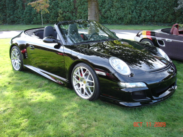

just for looks actually, i don't track my car.
If i just switch out the springs, will it hurt my car's suspension though? I was warned this will...Please advise, thanks!

Unless you've got money to burn, bad idea. Labor is basically the same for either, parts is where the difference in the price is. Why pay for labor twice. Pick what you want to go with and do it rather than springs first and C/O's later.
FWIW, I've got TechArt springs on my car, PASM continues to work perfectly and have no regrets. Lot's and lots of threads and opinions here on springs vs. C/O's.

Not sure but cars equipped with PASM do sit lower. TechArt springs drop cars with PASM 15mm and cars without PASM 20mm.
My drop was 15mm and I think it is perfect. Gets rid of the huge wheel well gap but not dropped so much that it makes the car undrivable or looked slammed. Here's two pics. The last one on the grass makes the car look lower to the ground than it actually is because the grass is kind of tall.

Whatever stock C/O's is what I have as I only added the TechArt springs and not any aftermarket C/O's. Sorry, wish I could be of more help.
If you go springs and are worried about dropping the car to much, be careful with H&R as they drop the car more than TechArt. Also, some claim (including a major sponsor here on 6speed) that H&R's tend to sag over time.
