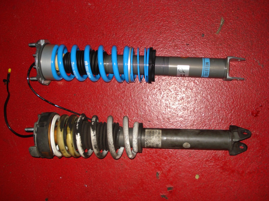

Here is a picture of my Turbo (Techart) spring next to the Bilstein coil over . I went from stock, to springs to coil overs (3 differerent suspensions). I like the coil overs the most . Beside the adjustable ride height I felt that when I compared the two my opinion was that both planted the car .. but with the springs I felt more stress was placed on the tires but with the Bilsteins the suspension worked with the tires in a more fluid manner.
