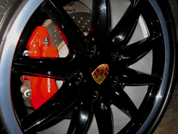

I just put the black on mine today. Used duplicolor grey primer and gloss black. $8.00 total. Cleaned the lug bolts with comet cleanser to create a water-break-free surface, dried with a hair dryer, masked so only the heads were exposed, mounted on a piece of stiff cardboard and sprayed. The whole job took an 1 1/2 hours and they look great. When I put the silver wheels on, I'll strip the black and paint with silver. Easy.
Glad it worked for you, post some pictures soon.
Here you go!

That looks great! Nice job.
Here you go!
Very nice. I guess that's the ticket. Thanks!
