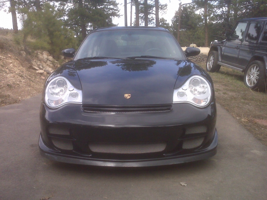

can we get a wider angle so we can see the whole front end?
Here ya go...
Vince

id go with a finer mesh and in black... that mesh wont do anything besides look cheap..
they make finer mesh you can guy elsewhere... that just looks like chicken coop mesh. :-(

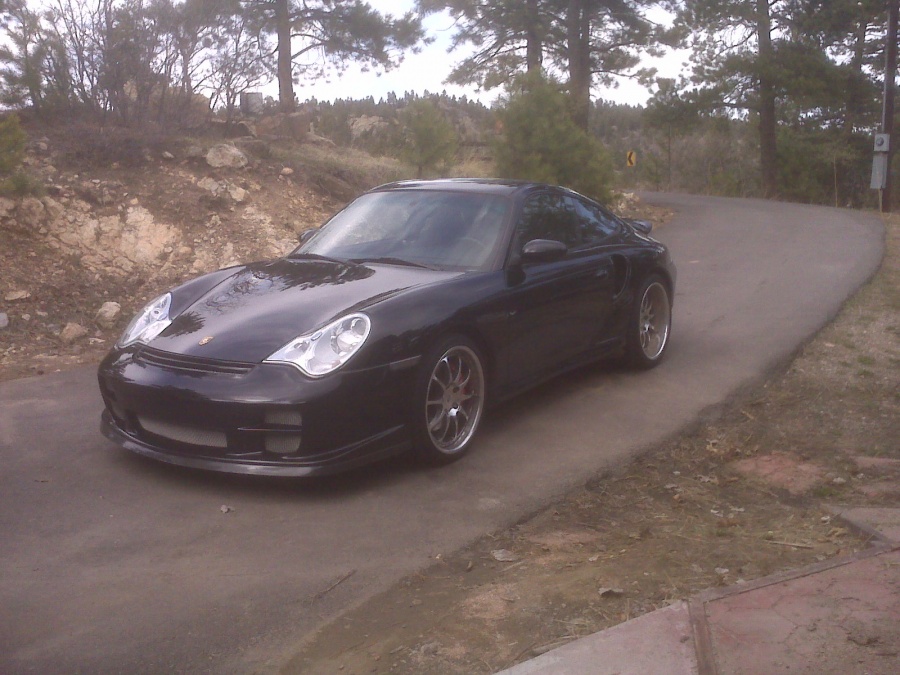

I put them on my 996 Turbo both for looks and to protect the radiators from rocks. I went with a smaller mesh though since here in the mountains there's tons of small pebbles that would go right through that big mesh.
I like the look of the silver grills with the black car. I think it's a nice complement to the silver wheels. If I go with black wheels at some point, I'll likely paint them black too.
I beg to differ with you. It actually looks pretty good as i've already gotten compliments from several people here in town. And no, they don't live in FARMS so they won't be biased towards the chicken wire look.
Hey, everyone's entitled to their opinion. I welcome criticisms. Bring it! LOL
