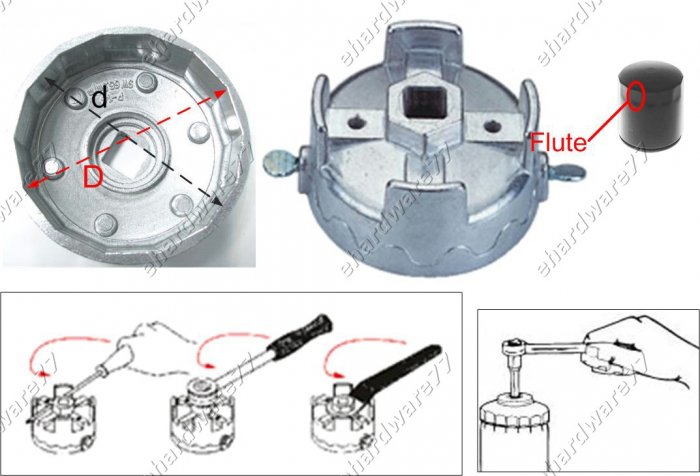

Thanks to you, JEllis, I will be changing the oil on my car this weekend. Ordered the LN magnetic drain plug & OEM oil filter wrench from Pelican Parts. There is a great oil special at O'Reillys. I am opting to go with the K&N oil filter cartridge as I cannot see the advantage of the spin off adapter to justify the cost. I will also bleed the brake system and change the spark plugs with some help from a buddy. These posts are a great resource.

This is what I bought last year but for the life of me can not find link to place i bought it from here in USA. It was under $30.00 and fits Porsche oil filter perfectly.
Oil Filter Cap Wrench Info:
WOLF'S HEAD model WH-903 L
Also has wing nuts on sides in case you need to use with slightly smaller oil filter casing.
BTW, I also bought LN Magnetic Drain plug w/ Oil filter spin-on adapter and will be installing at next oil change along with changing to Castrol 5W-40 from Mobil 1 0W-40.
