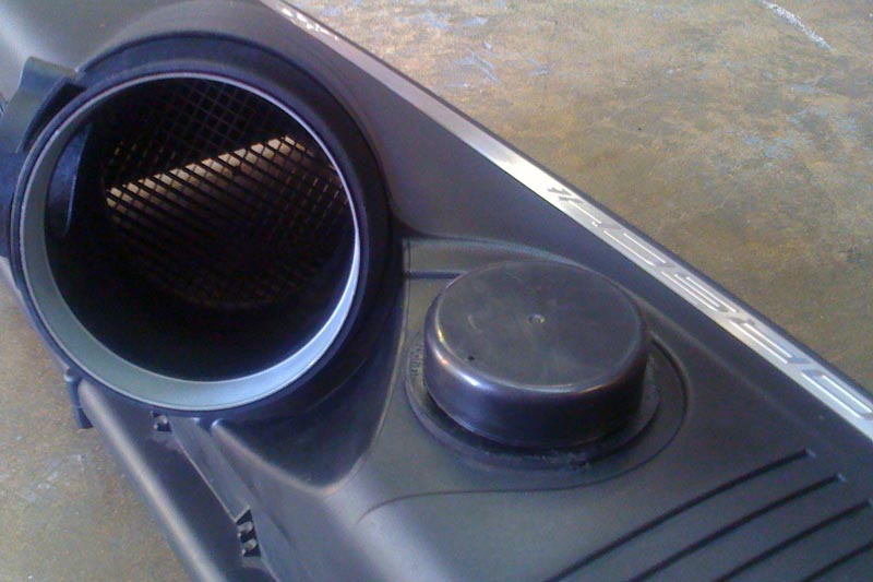

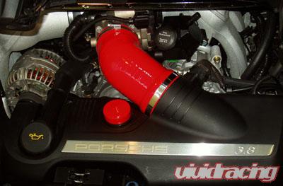

Originally Posted by 20-C4-10
this is interesting, i love the morning gurgle with my cg mufflers and sw bypass, if there was anyway to extend this note i'd love to learn about it... where is the cap on the resonator located? Would this mod potentially work on DFI cars?
This red cap covers the resonator. I guess im going to buy this pricy kit and give it a shot.
Save your money, just find a 2" cap and trim it down. Gillette shave cream seems to work if you have that around.
I had this cap on mine for about a year but removed it when my exhaust got so loud that it didnt matter about the intake anymore.
d
Any recommendations for the newer 997.2's with the resonator built into the air intake track? Ther is a flapper valve operated by engine vacuum but does the flapper valve close or open during high rpms?
d
Thanks for the info,
What did you use for the intake tube plug?
you just fit the cap over the resonator opening and then fit the rubber intake tube down over the cap, fits perfect and is held in place with the clamp.
just keep in mind that this mod does not get you the nice raspy gurgle you are after, just more of a wail after 5k rpm.
