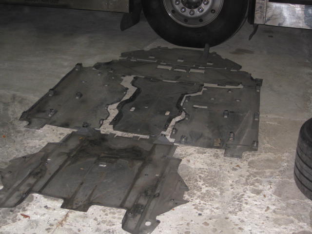

There are many reasons for removing the under panels, but among the most common are the need to access the coolant lines and the shift cables. With these panels removed, you also have great visibility up into the tranny and the engine, etc. Regardless, the 6 pieces fit together like a puzzle, in that there are places where one piece fits over another, or under another, and in fact you can get intersections where up to 3 or 4 panels overlap, and must be stacked in the right order.
Here is what mine looked like when I took them off for the SC installation. At the time, as I removed each one, I labelled each point where panels overlapped. Closest to the ground was "1", next level up from the ground was "2", and so on. It saved me HOURS when it was time to get them all back on again.
CATTMAN
