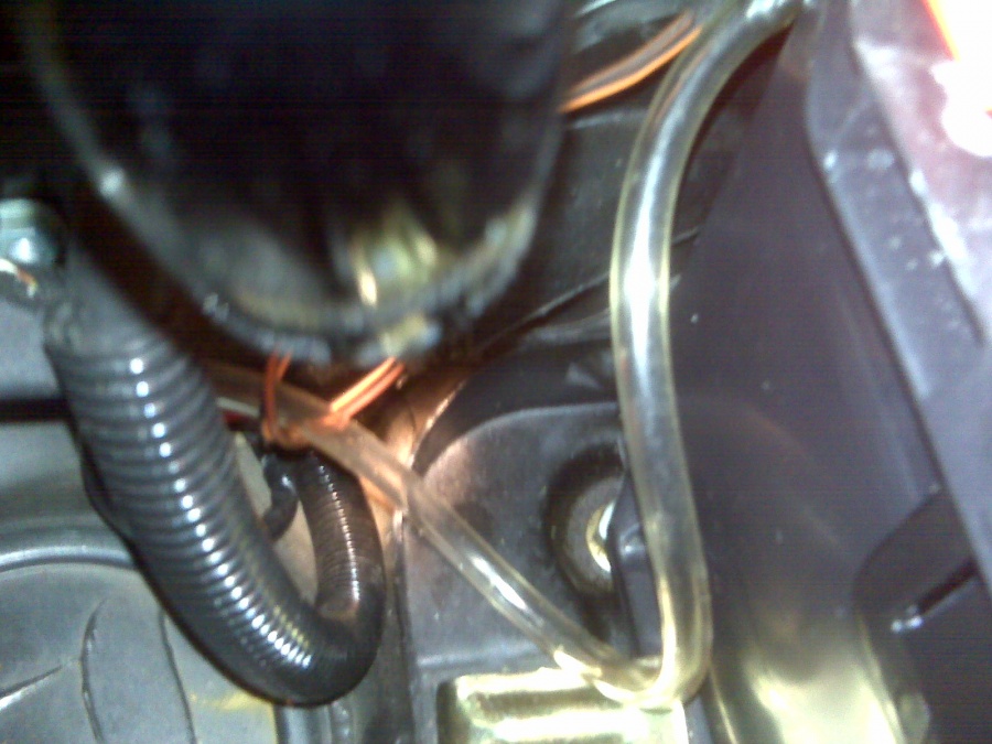

Use a shop vac and you can use a chop stick or one strand of #12 wire to push through the hole.

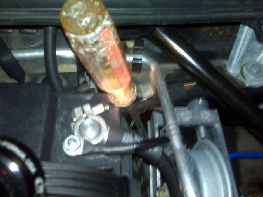

Where do these 2 holes drain? Do I need to remove the underbody panel as anything I blow out of the holes will sit on top of the panels?

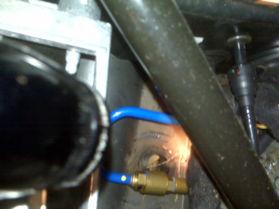

There are 3. Look to the left & right of the battery & they are in line w/ the windshield washers. The third is between the battery & the windshield washer filler (blue cap). The picture w/ the screw driver is to the right of the battery as you look at the battery. The rubber grommet is about an inch in dia. but it has a taper at the bottom.

Weedeater line is a good alternative. The plastic line is pretty stiff and flexible (no jokes please)
Thanks!

When I went to take the pictures so Johnny DB could see where the drains are located mine were full of leaves. I cleaned my drains 6 weeks ago. Our trees really don't start their major leaf drop until late December or early January. I was surprised to see how many leaves, bugs & other stuff were there in such a short time
