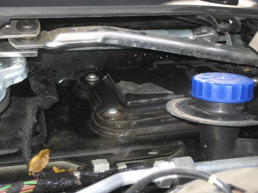

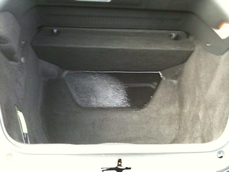

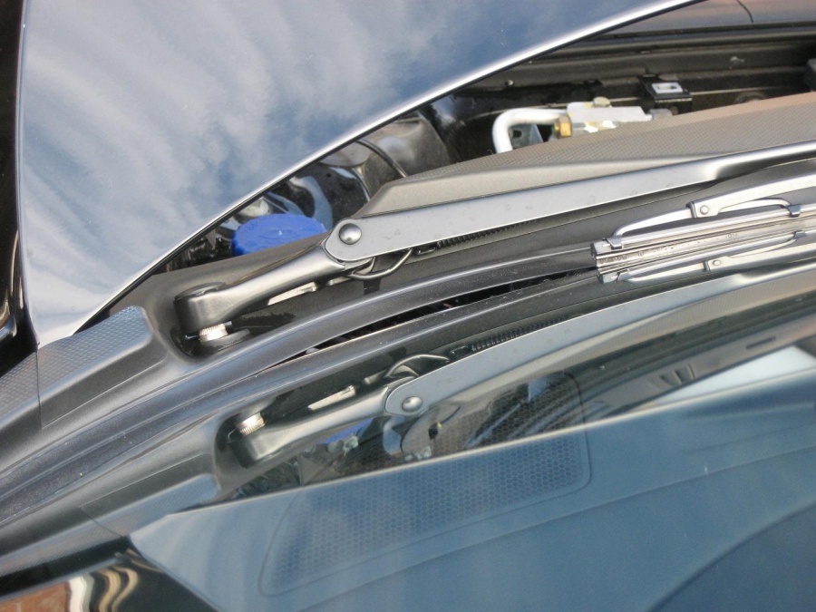

Hey guys! I washed my car yesterday as I was prepping it for storage. I opened my trunk to wipe the water off the plastic trim and discovered lots of water. See first pic!

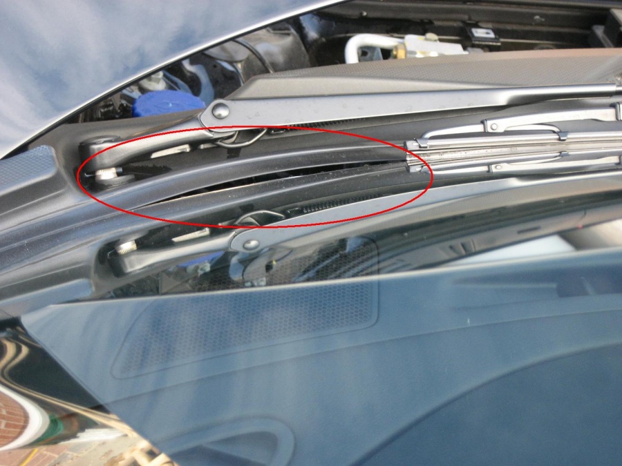

After wondering how the f^%&k the water got in there and removed most of the trim and panels inside the trunk, I figured out where it was coming from. The plastic piece between the trunk lid and windshield was lifted. This gives an unrestricted access for the water to enter the battery, master cylinder, DVD/CD and bottom of trunk areas.
I know I bought the car that way but never saw any water in the trunk. I then realized I was always washing the car with the wipers down, but not this time!! I’m assuming the wipers were directing the water away from this opening.
Does anyone know how to fix this or do I need a replacement part? Is this part adjustable? Anyone ever experience this?

I don't think thats actually a seal but more of a suggested barrier to the water. I bet your leak is coming from somewhere else.

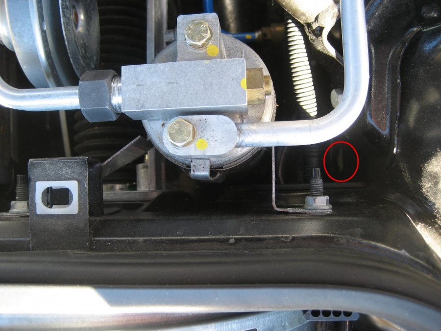

I really doubt it's coming from elsewhere. After having all trim pieces off, I ran water where the seal is lifted and it all came trough exactly where picture 4 shows. I ran the same test on the other side and it directs the water to the outer edge of this seal then drains in the door seam just ahead of the side mirror.

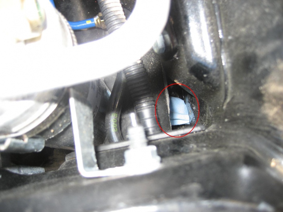

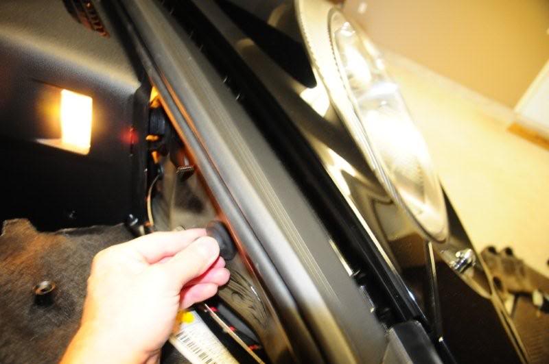

Also, in pictures 2&3, you see inside the trunk where the seal is lifted.

Looks like your plastic seal (where the wipers are) is warped. Mine doesn't look like that and it lays flat.

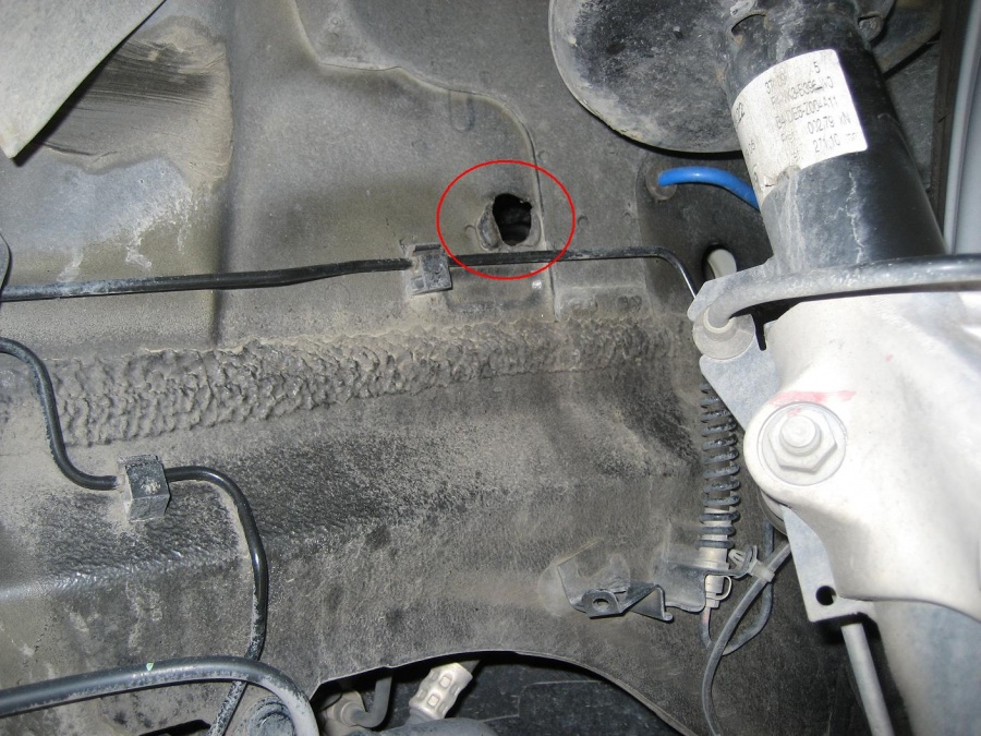

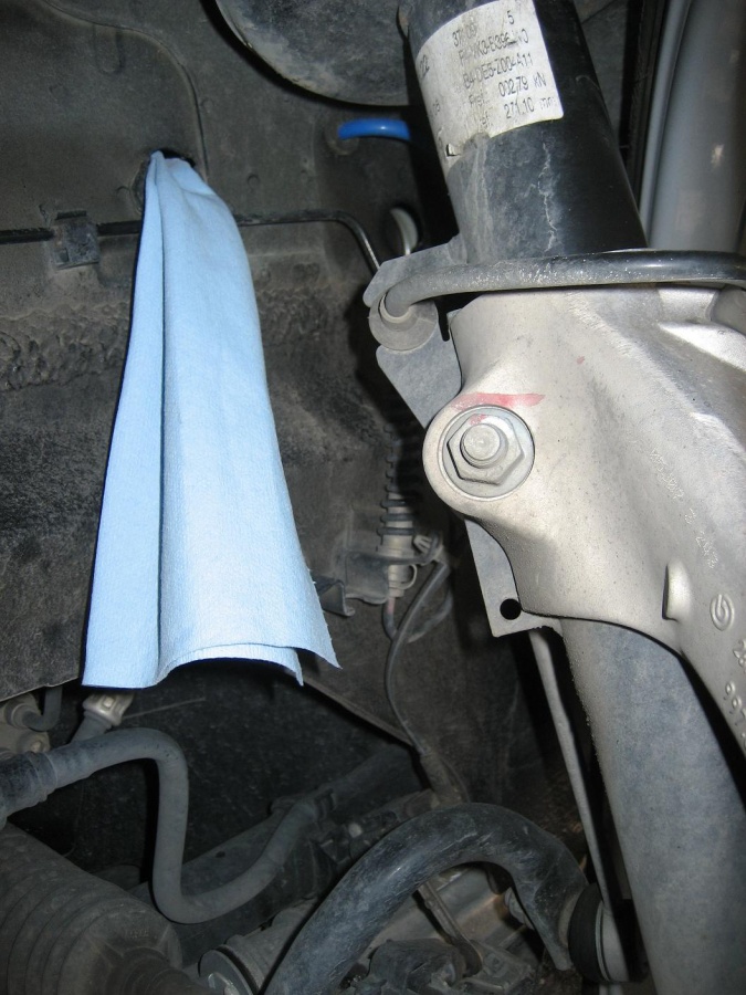

That aside, I did find a hole that goes directly into the area with the blue cap. I posted a picture of the whole from each side then with a blue shop towel going through. Should I have plugs there? I did wash my wheels and gave the wheel wells a good spraying with the hose.

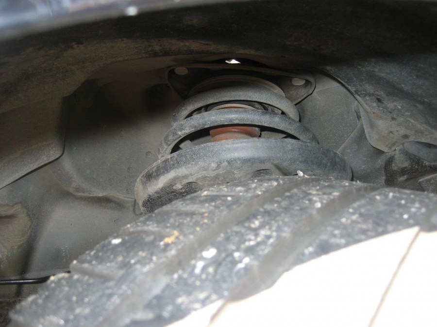

Also noticed a small hole by the shock...

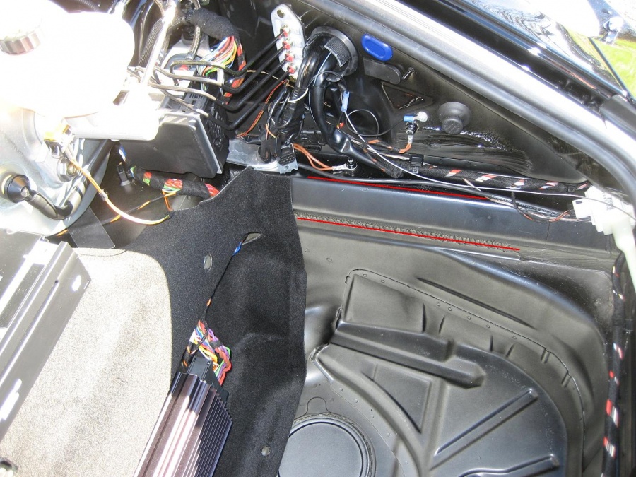

Also forgot to mention I found some water on the ledges highlighted in red.
Is it possible there was so much water that the wires going through the firewall aloud it to go by? How good are the firewall seals/plugs?
