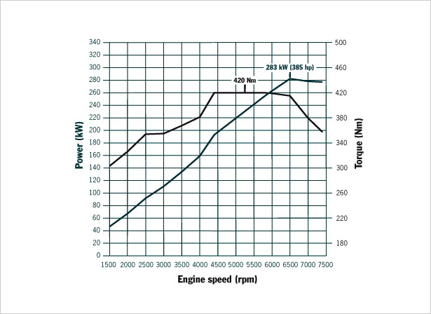

This could just be a normal characteristic of the engine. If you look at the factory power/torque curves for the 997S.2 motor, both tail off very sharply after 6600 rpm. My car feels exactly the same as yours with a noticeable change after 6600 rpm.

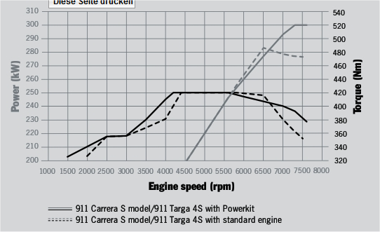

Interestingly, this drop-off in torque at the top of the rpm band is exactly what the X-51 powerkit for these engines addresses. With X-51 installed, the power continues to increase above 6600 rpm to the red line
Interesting observation. However I do not feel what the OP states; my car pulls strongly above 6500RPM. It makes sense however to shift right above 6500RPM.
Note that the std 3.8DFI engine has a very linear power curve to the peak, whereas the S51 variant is less linear, curving at around 5500RPM. I love the linearity of the std engine. Note also that the std engine torque deficit at 7300RPM (from the peak) is 7%, nothing significant. My car always surprises me above 6kRPM.
