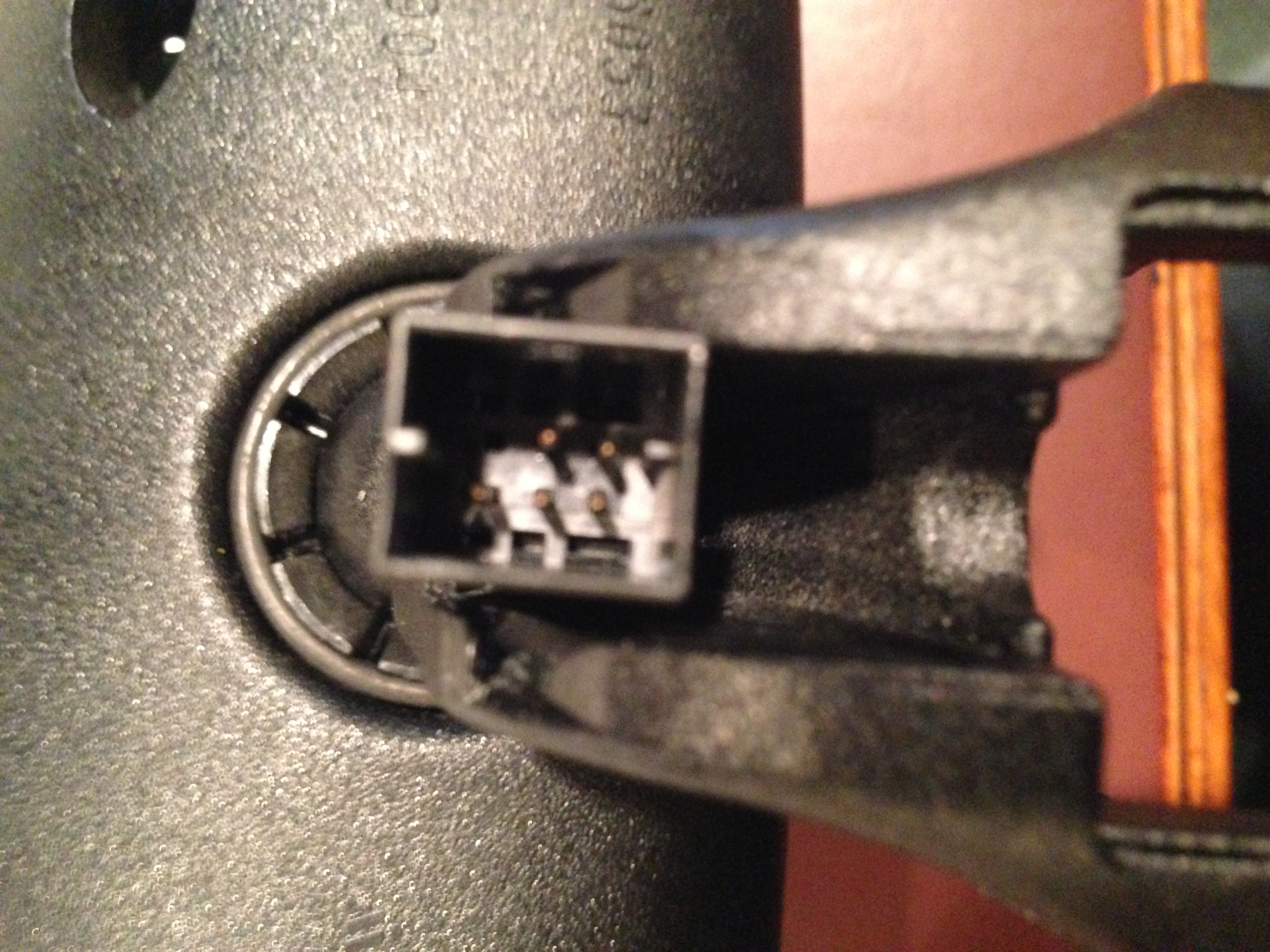

I need a little electrical advice before starting this project
I hope someone can help me here.
I received the auto dimming mirror from the wreck in Australia and it looks like it is in good working condition.
However, the electrical connector is a 5 pin (see attached photo). I figure the reason for so many pins is that the factory install uses the sensors from this mirror to control the dimming on the 2 side view mirrors. I don't need to worry about that. But how do I know which pin is the hot one, and which is the ground (or is the ground just part of the mount)?
Please any help or suggestions is most appreciated.

Just a disclaimer: All of this could be wrong, and if you provide power to the wrong pin you could burn out the mirror circuitry. If you have a good relationship with your dealer's service shop, maybe they could help. They should have the wiring diagrams.
That said, I decided to poke around the web for an answer. I like a challenge. The closest thing I've found was this for a Boxster - which probably uses the same mirror (text is directly copied and pasted)
For what it's worth, on a 986 they are;
A1 - TERM 15 (BK/OG)
A2 - TERM 31 (BN)
A3 - BACKUP SIGNAL (BK/BU)
A4 - ACTUATION + (YE)
A5 - ACTUATION - (GN)
I also saw a posting saying that the mirror is made to brighten when the car is in reverse, so that explains A3. Don't trust me on this, but I'd guess A4 is power and A5 is ground (not unusual for the ground wire to be green). Another wild guess is that A1 and A2 provide the signals to dim the exterior mirrors.
Now if you can figure out which post is which connection. Sometimes they are small labels if you look closely... just hopeful thinking.

Another thing I've discovered is that the mount of the base to the windshield may be different for auto-dimming vs non-auto-dimming. You might want to check to see if you have a mounting problem before proceeding further. Hopefully I am wrong. Maybe the difference is related to the rain sensor.
In any case, I'd suggest you check the base first to see if it will even mount.

I'm not sure about that. From other German car wiring specs (VW's I've worked on for 20 years) TERM 15 may provide power and TERM 31 may be ground. One is switched power (I think Term 15 black-orange, likely switched hot when the care is not in deep sleep mode, and one is to ground (I think term 31 - brown ).
Actuation - yellow wire and green wire - are signal lines or something.
Remember the mirror has a location-light(ambient low power light) that is on and powered independently of the mirror dimming, so there needs to be power provided by a source that is not the dimming feature.
