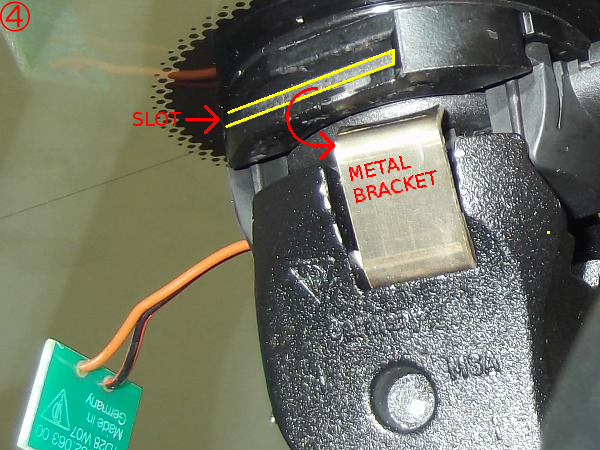

  2. With the housing cover removed, you will see the mirror post attached to the windshield. There is a metal bracket on both sides clamping onto the base in grooves. The mirror post looks like it will simply slide off these grooves, if you press downwards towards the windshield, but it is too tight. Also, there are wires connected to it, and they would break. So do not attempt to slide this out.
  3. There is a little electronic chip with the light diode on the bottom of the assembly (Picture 2). This chip slides out easily by gently pushing on it, downwards towards the windshield. Be careful not to break the delicate wires. There are other wires connected to the mirror post from the back by a connector plug, but this connector plug can not be removed yet.

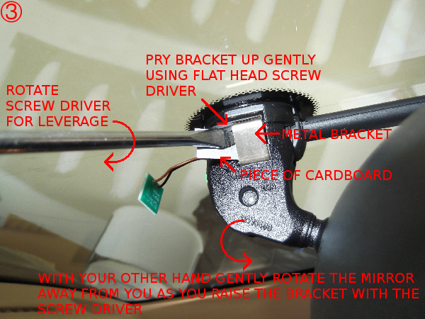

  4. Take a medium thin flat-head screwdriver, slide it between the left metal bracket and the mirror post, and gently twist the screwdriver to pry the bracket up, out of the groove (Picture 3). Brace a small thin cardboard between the screwdriver edge so you don't damage the plastic. The metal bracket will start to come up out of the grove, and the mirror and post will be angled away from the windshield. Take your time and do not pry the metal bracket any more than necessary, because the tension will be necessary to hold the mirror post in place when we reattach it to the windshield. Adjust your screwdriver and continue to pry the bracket up further while gently pulling on the mirror, being careful not to scratch or damage the plastic groove. The mirror will simply pop out (Picture 4). But don't yank on it or let it drop.

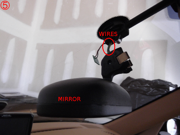

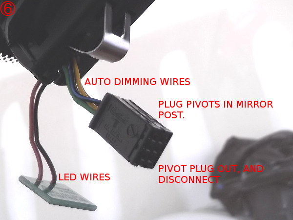

  5. The wires and connector plug will still be attached (Picture 5). The plug pivots freely, and there are two tiny clips on the left and right of the black connector plug. The female portion of the plug is attached to the mirror, while the male portion is attached to the wires from the headliner. Use a tiny flat head screwdriver (like the kind used for eye-glasses repair) to gently pry both sides of the female connector plug up, so the clips on the male plug are released. Then slide the male portion out (Picture 6).

  1. The mirror and all wiring will now be free (Picture 6).

  2. To reattach the mirror to the windshield, first reconnect the auto-dim wire plug as in Picture 5. Then place the right metal bracket into the slot on the right side of the mirror-post base (Picture 4). Again use your medium screwdriver to pry up the left metal bracket until it fits into the slot on the left side of the mirror-post base (Picture 3). Slide the light diode chip back in place (Picture 2). Finally, replace the black plastic housing that covers the mirror post.
