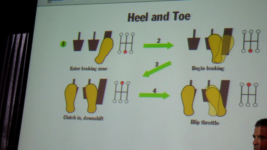

Heel and Toe for down shifting...not recomended for the street but this is what you do. To do it correctly you have to do it fast and it takes more brake pedal pressure than you will need for street driving.
Your rev increase when upshifting is because you still have your foot ont eh ags when you push the clutch pedal...simple as that!!
