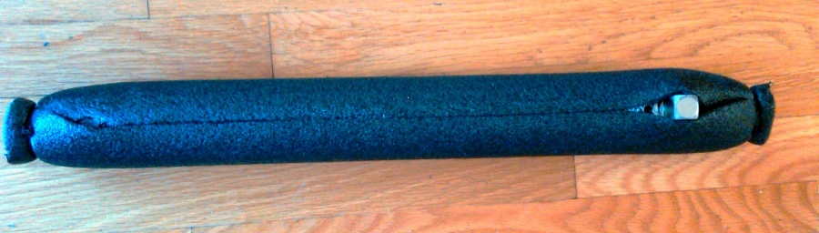

DIY: Center Lock Wheel Breaker Bar "Cuddly"
Guys,
I carry the CL wheel breaker bar with me under the bonnet and don't want it wobbling around and extending itself and beating up the inside of the trunk...
Read Victor Hugo's story the "Loose Cannon" and you will get my drift....
http://www.online-literature.com/victor_hugo/3067/
Anyway, I went to hardware store and bought a length of 1 3/8 " split pipe insulation, cut it to length, and secured the ends with zip ties.
The breaker bar is now secure in its cuddly - and I keep it wedged and secure in there between tool pack and first aid kit.
Check it out, and regards,
UJ
