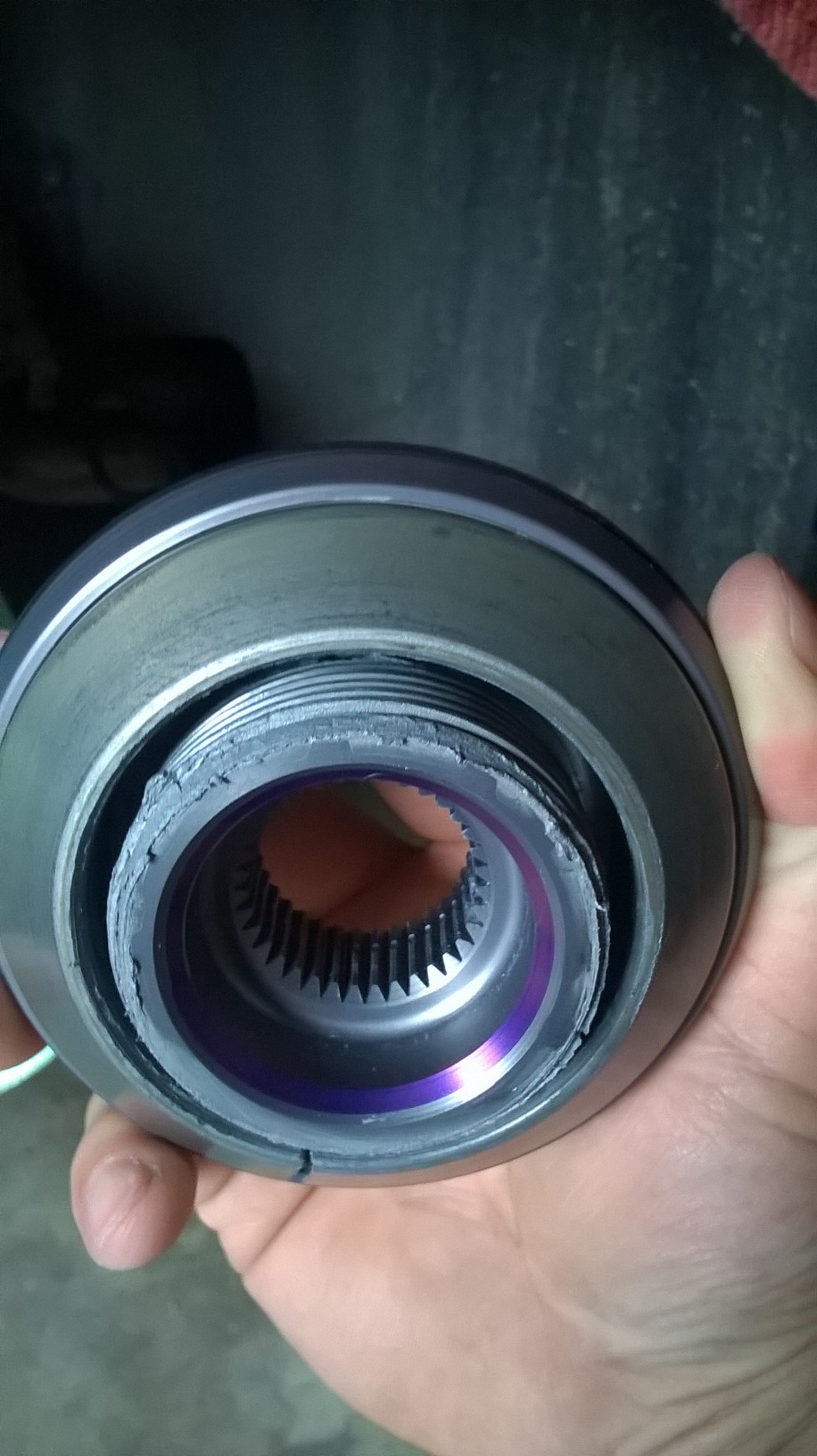

Decided to take a stab at removal
Hello,
Picked up a screw entering the bank parking lot. Nearest Porsche dealer is 50 miles south...all the local shops dont do center lock wheels....surprise surprise. So, I decided to remove the wheel/tire and take it to Discount Tire for repair.
After researching and so forth, this was my experience.

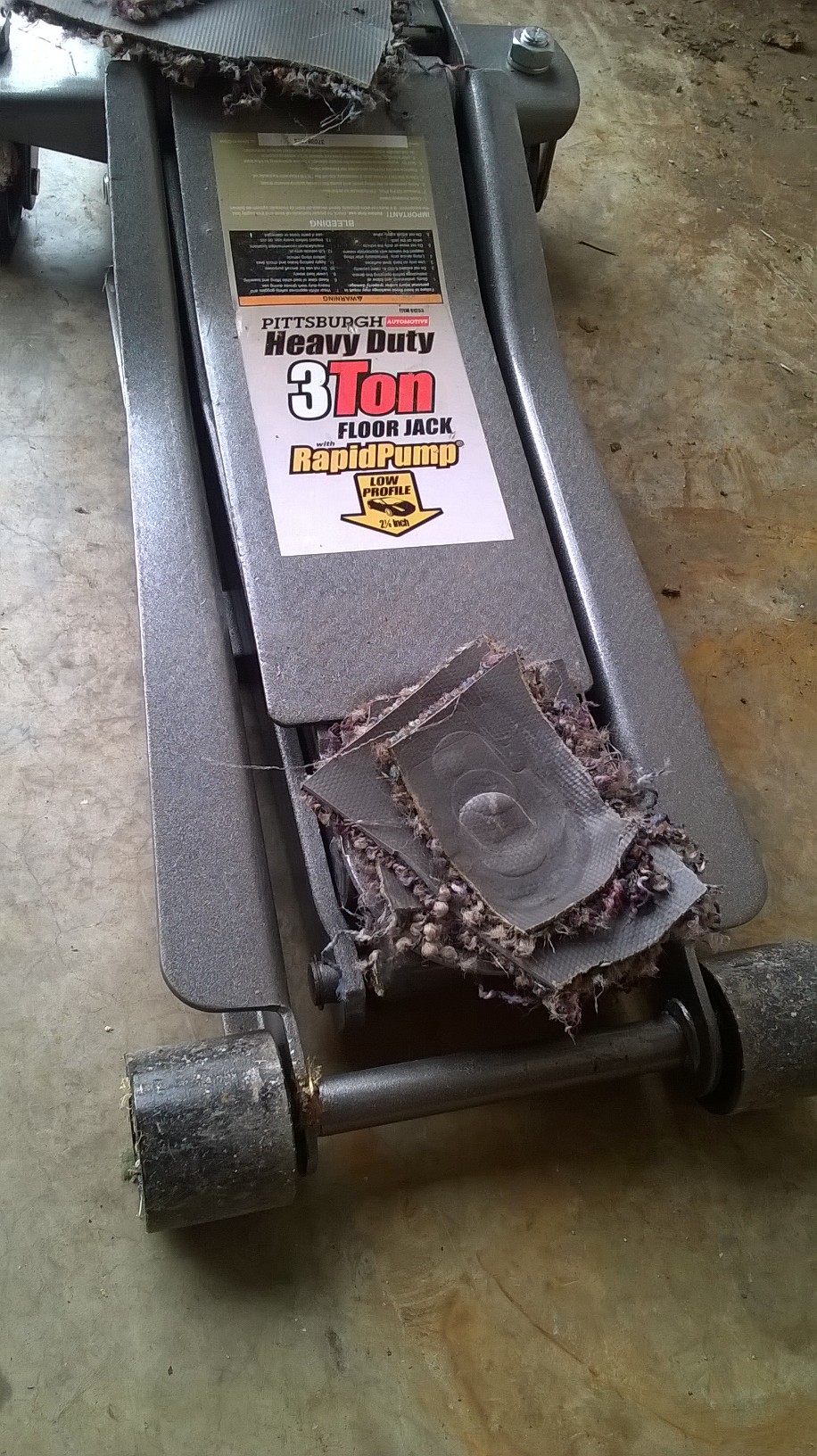

1. I used a low-profile 3 ton jack
2. Used pieces of carpet squares to fill the void between the jack plate and the actual mount under the car (instead of a hockey puck)

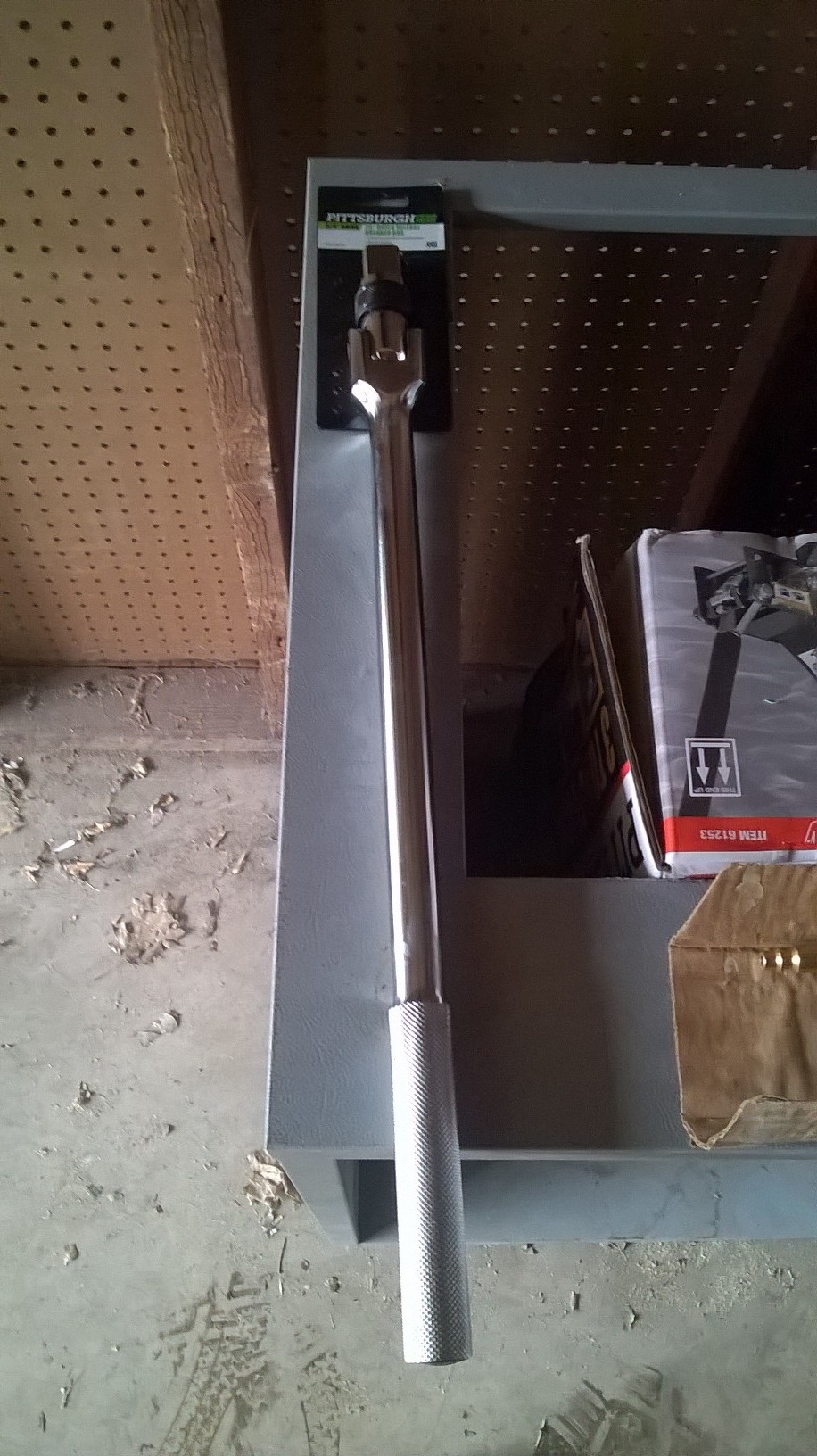

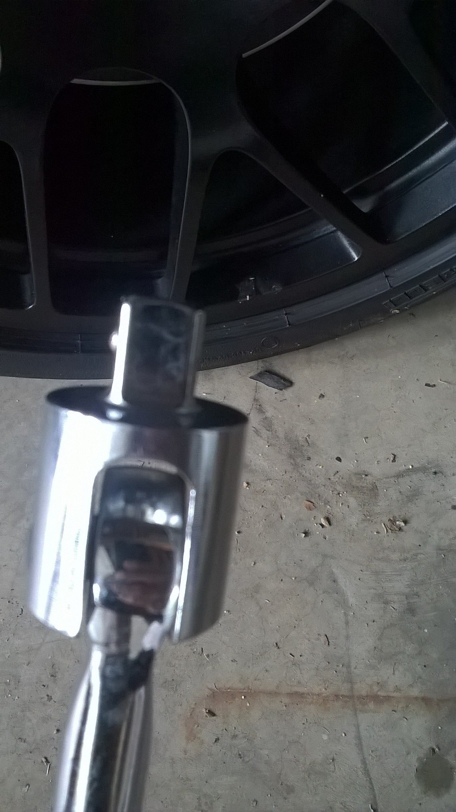

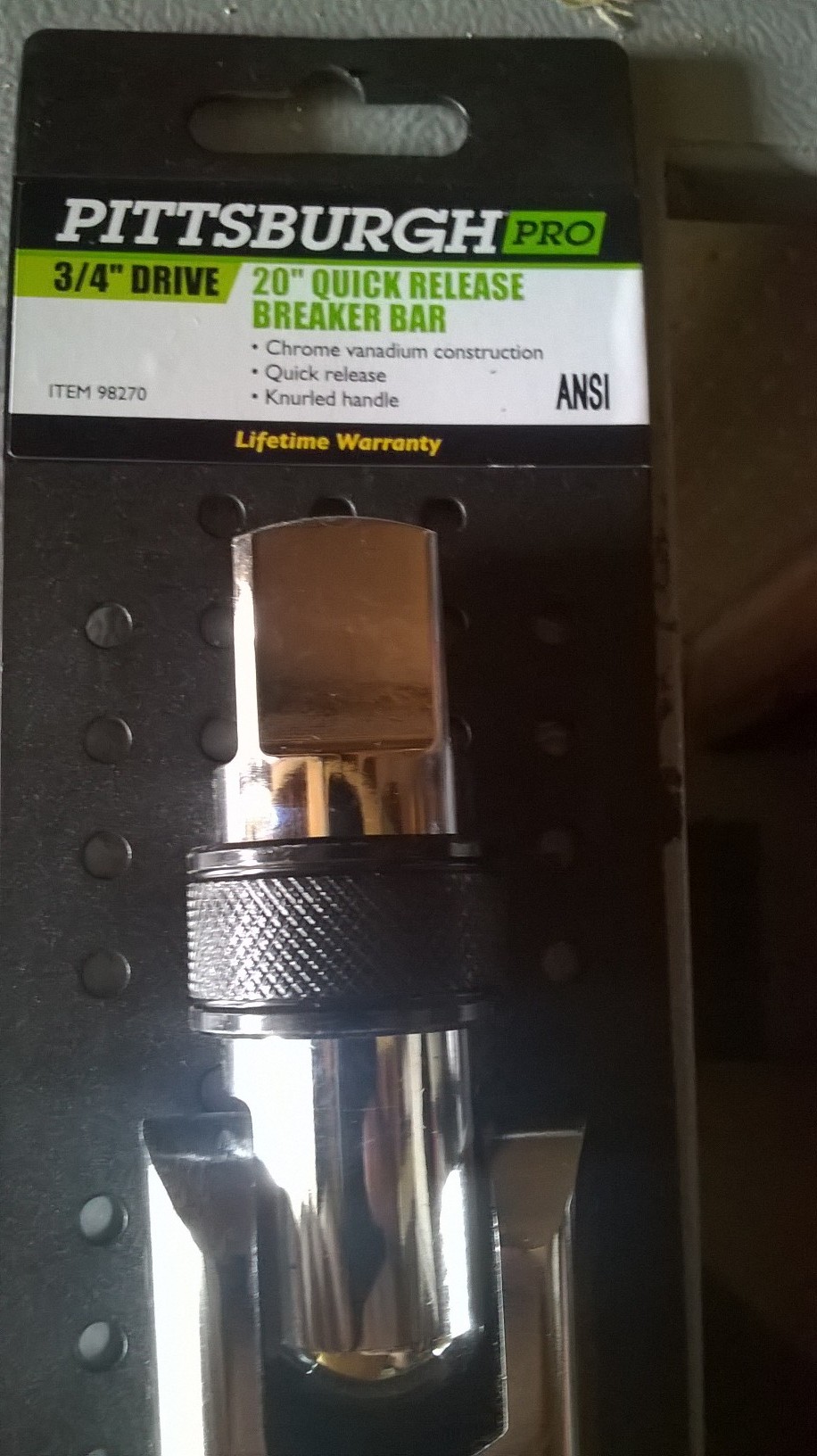

3. I used a 20" long 3/4" breaker bar from HFT
4. A friend let me borrow his 1000 lb/ft torque wrench
5. I used a 1/2" drive breaker bar to wiggle the locking pin/mechanism so it would be flush. I just inserted the end of the drive into the pin and very gently wiggled from left to right.
6. I also torqued the wheel to 450 lbs/ft
7. I did NOT use any Castrol Optimol TA paste as the nut and screw had plenty.
8. I placed soft towels over the ceramic rotor

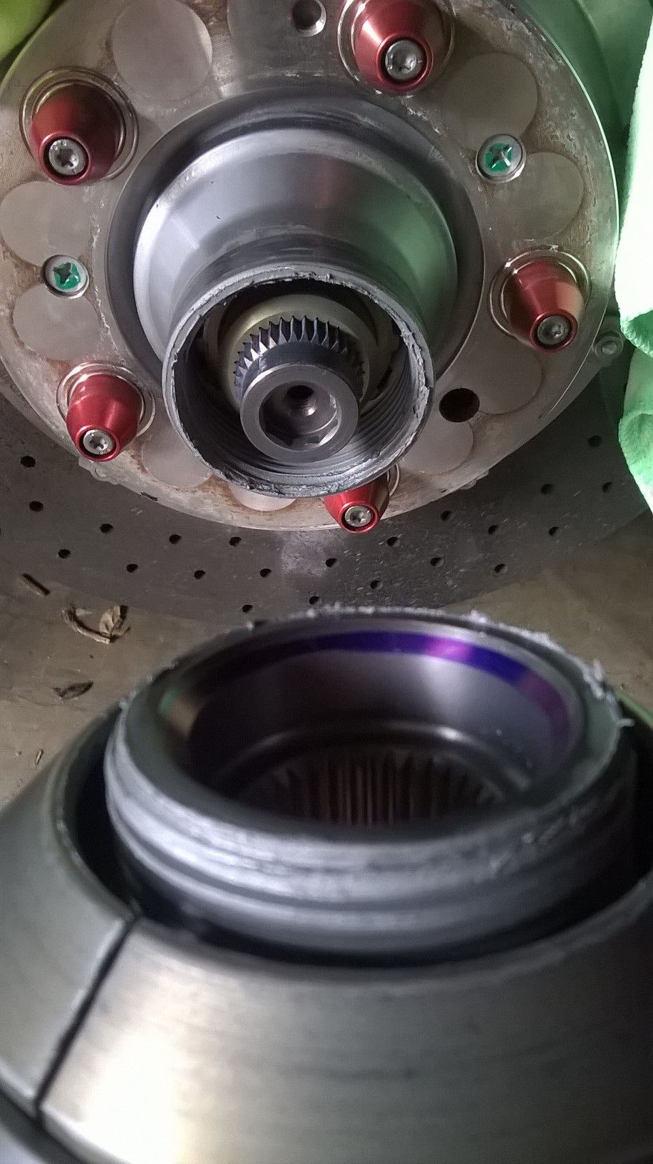

9. Once the nut was removed and the wheel was ready to come off, I lowered the car to where the tire was within 1/4" to 1/2" of the floor. This step made it super easy to remove the wheel without risking damage to the rotor. Plus, I didn't have to worry about not having the "wheel alignment" tool.
After getting over the sheer fear of breaking the car or screwing something up, I did the job.
For me, I used the weight of the car to keep the tire/wheel from moving when I was loosening the nut. Afterwards, I raised the driver rear side of the car to get the wheel/tire off the ground. Then, I was able to finish loosening the nut by hand. To tighten, I hand tightened the nut. Then, used the breaker bar to tighten as much as possible. I tightened the nut while the car was in the air. I lowered the car in order to apply the 450 lbs/ft of torque.

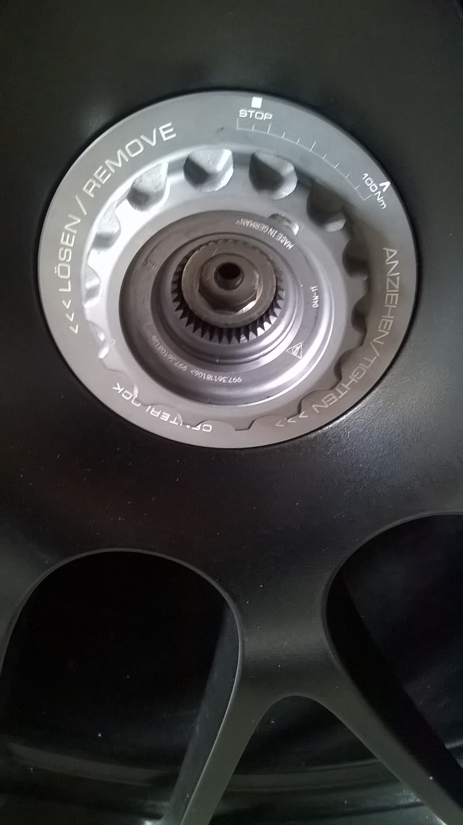

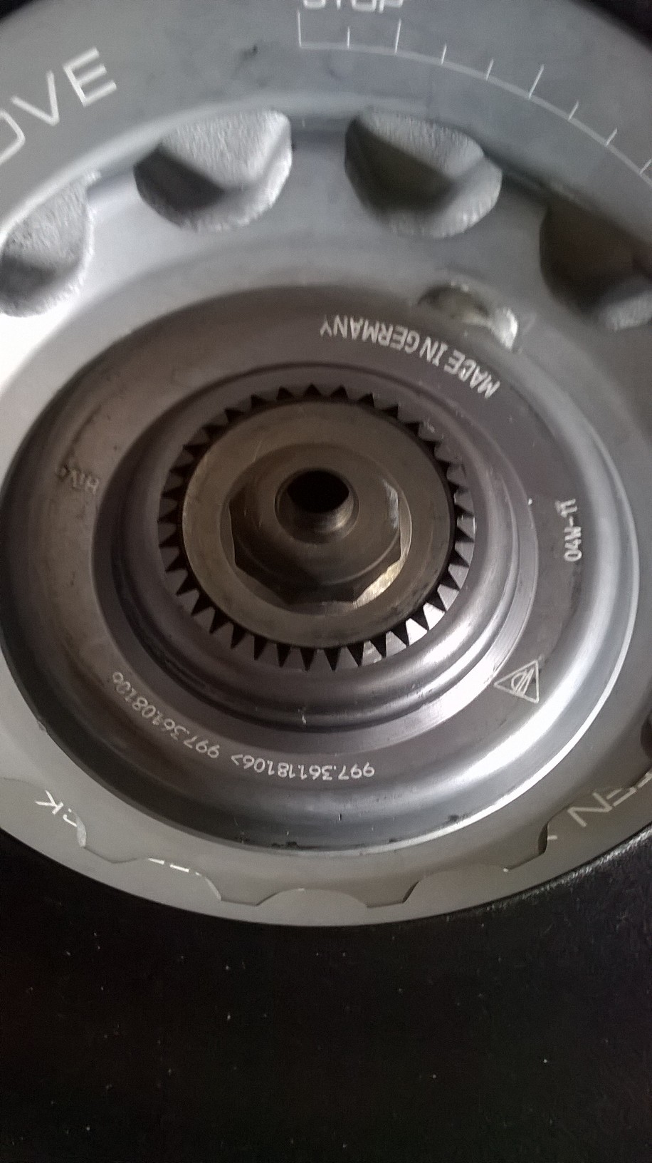

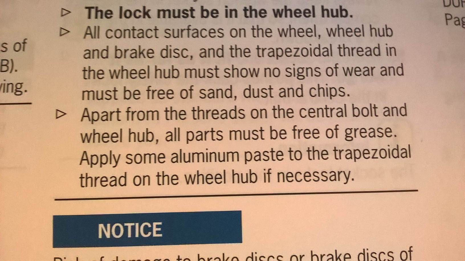

Some of the tools I used
Before and after pic of the flush safety locking mechanism/pin
The text is out of the owner's manual
