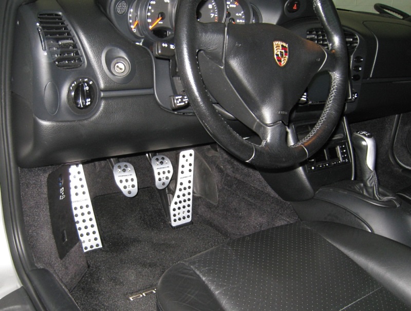

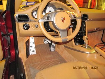

Quote: Does anyone have any pictures of these installed?
Here are the before and after pics from when I installed the after-market pedals earlier this month.

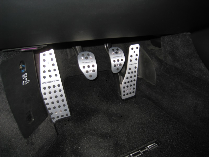

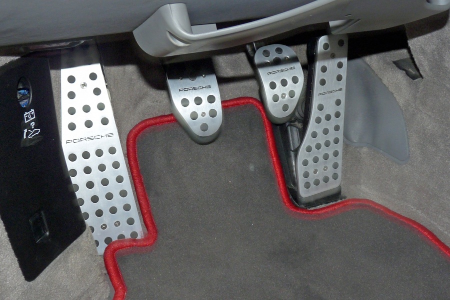

Sport Pedal Set
Here's how they look in a black interior.
