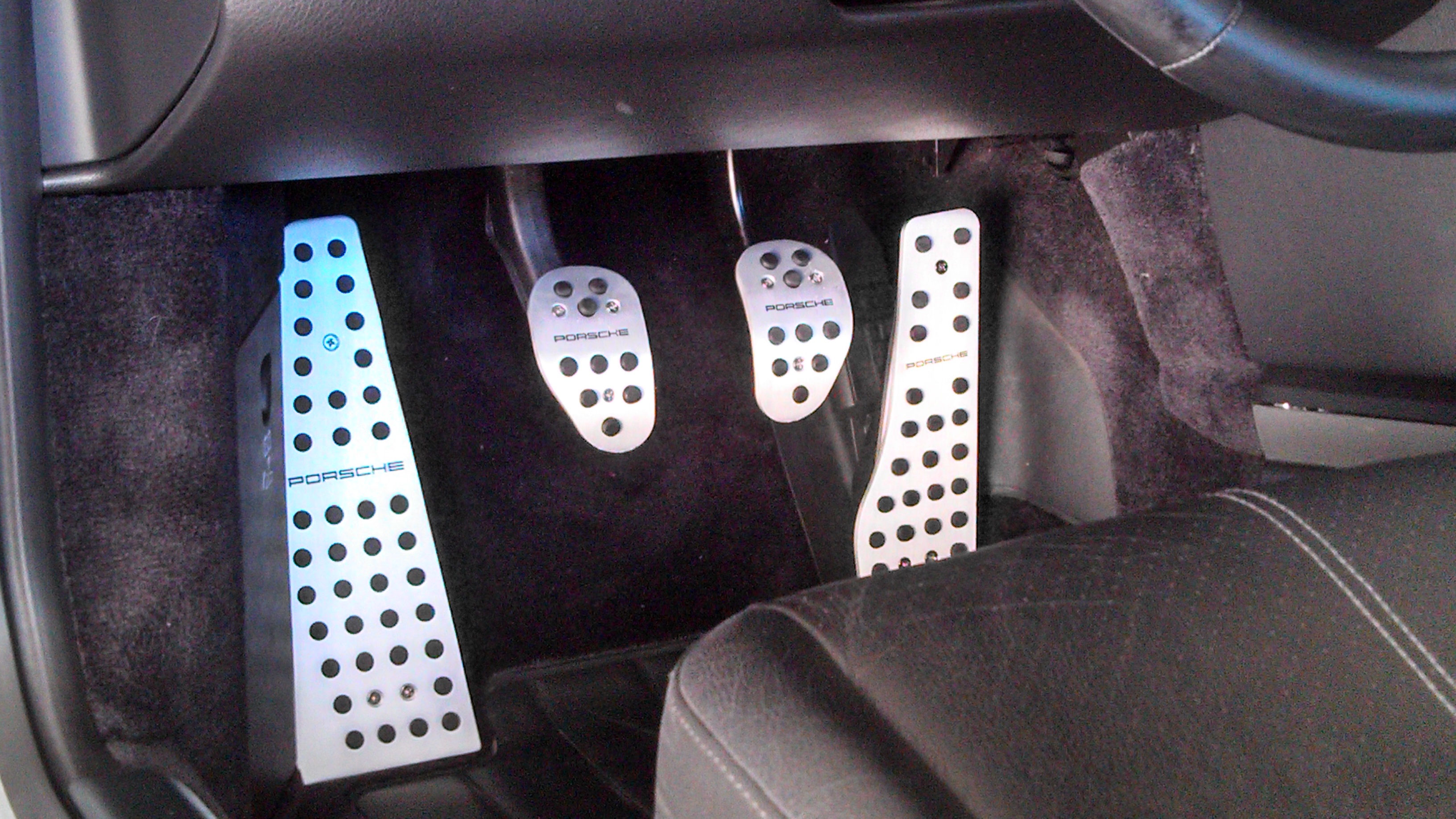

Here's a write up I did on some install tips. Drilling through METAL ... my god...it is NOT brain surgery.
http://forums.rennlist.com/rennforum...installed.html

Thanks to all for your comments. As far as installation goes, it's really nowhere as hard as some people would have you believe. Trust me, I'm no genius in the DIY world, and if I can do it, almost anything with opposing thumbs can do it. My only tips (as have been stated in a million other places on the web) is to TAKE YOUR TIME doing this. The foot rest (on the far left) and the accelerator are easy--do these first. Then, remove the brake and/or clutch pedal rubber covers (they pull right off and can go right back on if you chicken out or screw anything up), cover them with masking or painters tape (the lighter the color the better), and line up your new pedals. Using a pen, mark where you want the holes drilled. Then I recommend after you drill the first hole (use a new/sharp drill bit...and drill slowly--the tape will actually help keep your drill bit from slipping/sliding), go ahead and affix the pedal using the included hardware. Once you have one bolt attached you can then position your pedal more easily, drill another hole and repeat. Again, it's really not hard at all. Good luck to all!

Here is what they look like when installed...on C4S!
