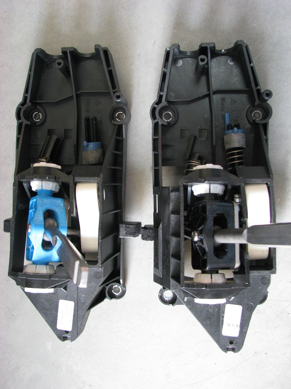

New to Porsche and was wondering how you would tell whether a 997.1 has the short shifter or not just by looking. Are there visual clues or must I measure the length of the shift to determine standard versus short?

I just swapped out shifters on my 997.1 It will be difficult to tell (visually) if the car has an OEM SSK. You can definitely tell by feel. The SSK is notchier and has a shorter travel throughout the gears.
You could peel up the leather shift boot and this will reveal the part number. There is a thread on this forum that gives detailed instructions on how to do this.

If it was done with Porsche SSK kit, lift the shift boot like the following photo. If the plastic pivot block is blue then it is short shifter (left in photo). If it's black then it's stock shifter (right in photo).
But if it was retrofitted with B&N short shift kit using the stock plastic pieces, then you won't be able to tell visually...
Great photos! easy to tell!!!
