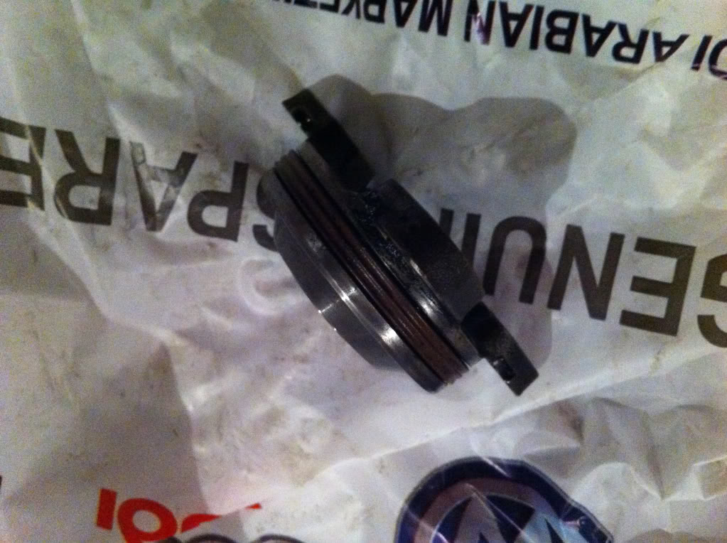

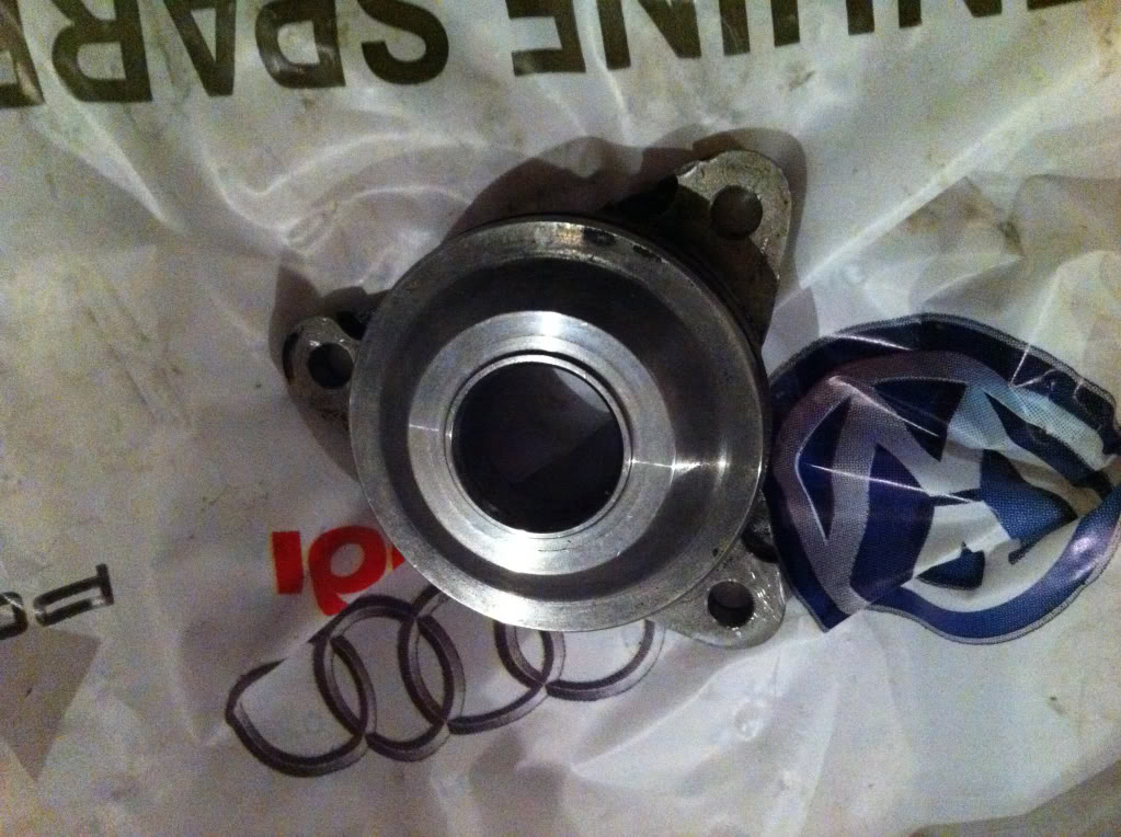

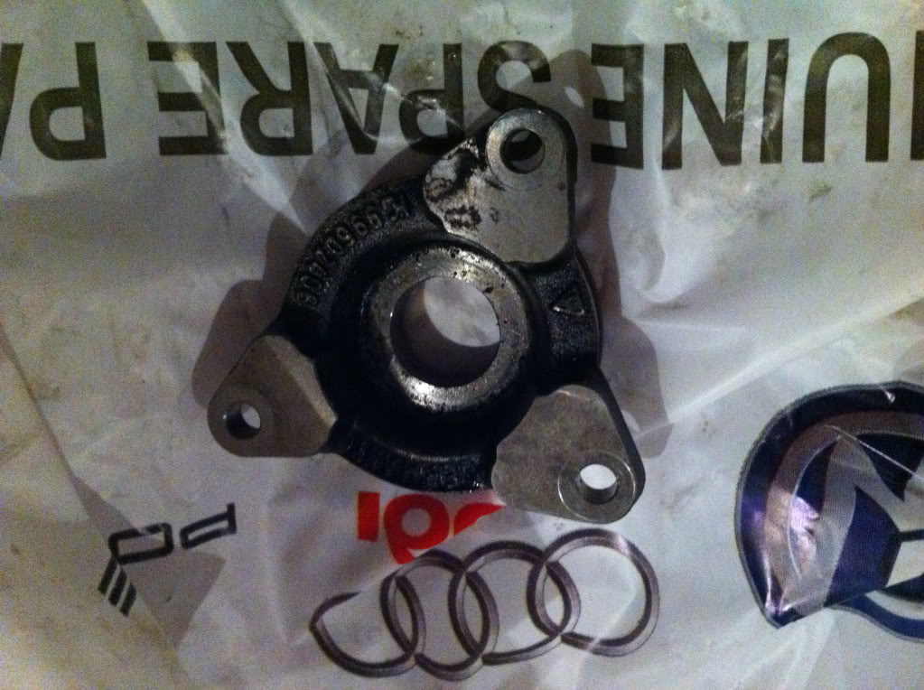

My old IMS

Your pictures are of the flange and not the bearing itself. The bearing is bolted to the flange. The bearing and flange should look something like this.
Here is a link which describes in great detail how the IMS bearing and flange are mated.
http://www.lnengineering.com/ims.html

Oh yes they did change it and it was ok , when they open the flange I saw it and I tried to shake it it was ok , but I wasn't there when they remove it
(I have no pic for it )

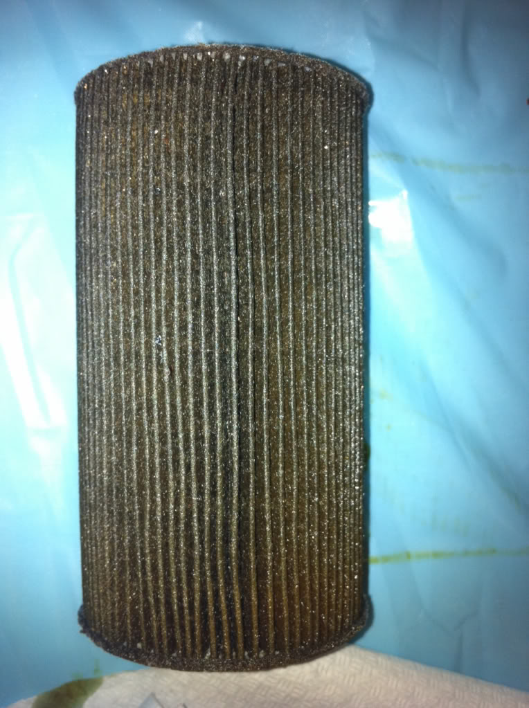

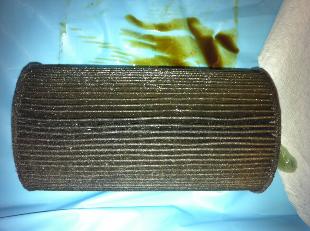

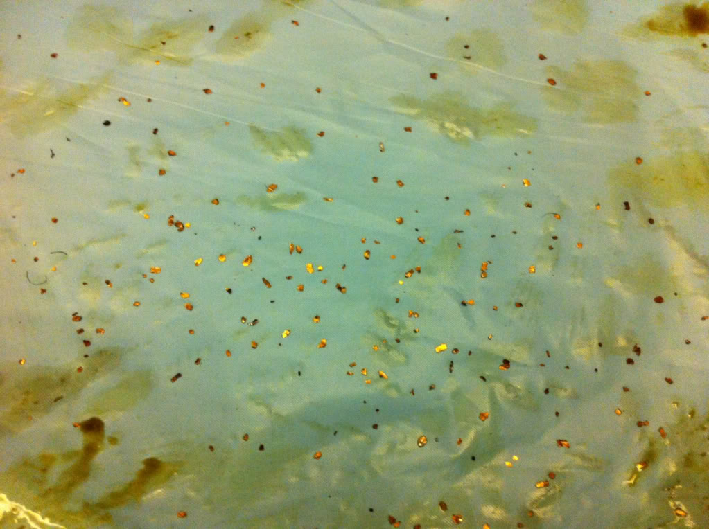

Here is my oil filter ::

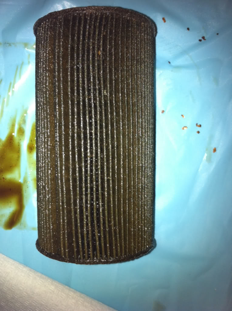

And here what I found Inside the filter ????
BTW, Its very very small but in the pic it look bigger and it did not stick to a magnetic
Any idea for the source ??

Thats a real mess. How long was that filter in there? Is that different from what was in the oil pump? If you rub it between your fingers does it feel soft or like sand? Have you taken the car back and are you driving it?

Is that metal? is that the same material that was in the oil pump?
Aluminum wouldn't stick to a magnet but that would mean it was block or head material right?

someone with good engine knowledge (probably on this site) will tell you exactly what those pieces are from based on the color alone.... we are all waiting.
Looks like brass to me. (bearings??)

As I understand it there is a bypass in the oil filter that operates if filter is clogged. Everything gets dumped back into the motor. That would likely have happened here judging by the pix. Probably rebuild time. Wonder what the service records look like if the filter is any indication. Obviously no one looked into the filter before putting money into this. I feel like something is missing in this story.
