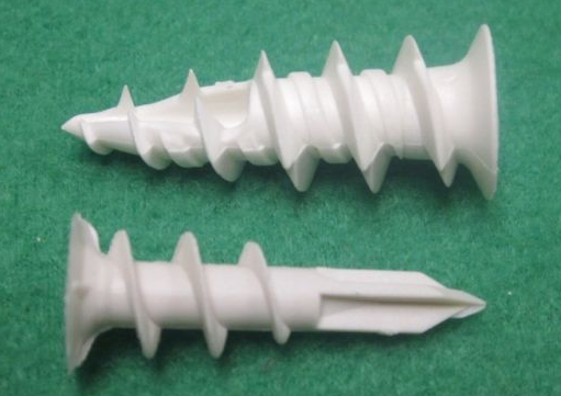

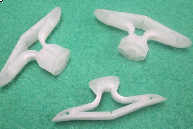

I used these 5 years ago & the plate has been fine since. Put the plastic molly in former screw holes then attach the plate to the molly with stainless steel screws. You can get these @ any hardware or home store.

Thank you for that. I was thinking along the same lines but unsure which ones would work best.
Thanks again!

I have also used these on my daughter's VW. You have to use a short neck version so you don't have any play. Of the three in the picture the one in the bottom is close but I still think you may have to go shorter.
