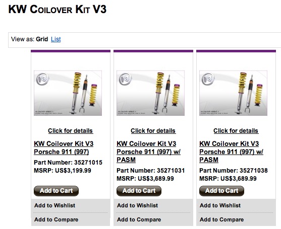

I am currently debating over which street CO kit I should get, PSS9 or the Bilstein Damptronics or KW V3 which I am currently leaning towards to.
KW site listed 3 part numbers for 07 C2S, 1 for non PASM and 2 for PASM cars.
My question is whether its the same spring/shock in the 3 different part numbers, just that the kits for PASM has an addition "Cancellation Kit" to plug into the PASM lines to fool the computer to think that the system is still there or are the PASM kits similar to the Bilstein Damptronics?

If the kits are all the same, I will just get the version without PASM and turn off PASM from the shop PIWIS computer to save some $.

I've had the KW Variant 3 COs for several years now and have been very pleased with them.

mkatkins, do you know if your V3 is the "Without PASM type" or "With PASM" which has a big resistor to plug into each harness?

Mine are without PASM.
