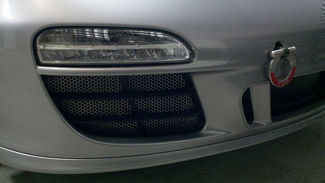

GTS - screen for bumper
I found some material at a local metal fabrication shop. There are numerous "mesh" styles, gauges and materials. I chose a hex design in aluminum. The local dealer did the install, total installed cost was less than $275. Stainless steel is nice, but not as pliable as aluminum when "fitting". Regardless of your bumper configuration, you can source material and either DIY or have a professional do it. I know what would happen if I tried to remove and re-install the bumper cover - things would get broken.
