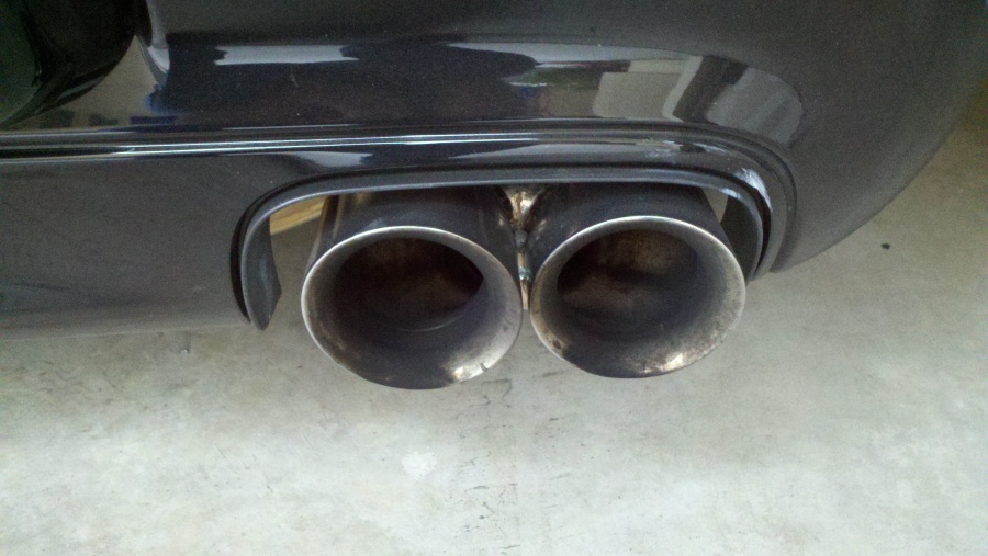

Is it normal for the LEFT exhaust tips to be dirtier than the right?
I've read a few threads where the LEFT tips had much more soot than the right, and the car ultimately required an engine replacement. Am I screwed? See photos below. The car is a 997.2.

I get that too lefts filthy wit soot

With a 997.2 you don't have to worry, only a potential problem on the 997.1.

There are older threads related to this that you should search for here and on Renn. ("left tailpipe....etc) Your engine will be fine if this is the only symptom you have. I really don't want to redocument my experience here (long). Do the searches and if you still have q's repost.

My 06 has done this since new. Porsche ran a complete workup on the motor including compression, leakdown, plug inspection and borescope. They found nothing wrong and reported the #'s to me. Very strong. There are tolerances in manufacturing and the stacking is random if you get what I mean. One bank is burning a little more oil than the other is all. Or you could say one is burning less oil since these motors do tend to use a bit or more. My motor now has 30K miles. It runs stronger than ever. Oil consumption has dropped to less than a half qt in 3K miles. Still one side darker than the other. Have Porsche Customer Satisfaction note this for you and should there be any problem down the road you are covered. Symptoms of cylinder wall failure are extreme. Heavy clouds of smoke from one bank, engine seizes will not run, clanking sound. This is known as "D chunk " failure in the .1's. What Vancouver was saying is that this has never been reported to happen in a .2 motor afaik. That is not to say it could not but to be honest you have no real reason to worry (no more than ne1 else that is Register your concern and annoyance w Porsche thru your dealer. Go on and enjoy your car. It is merely cosmetic and if it really bothers you can get the exhaust tips blackened I have run my car against 2 others and mine is faster so there is no performance issue. Just for my info, how much oil are you burning and what is your milage?

Hello. The condition on my 06, which at 45K miles lost its engine was markedly more severe than yours. Soot much heavier. For me the right bank (pass. side) ultimately failed. This of course is the bank that feeds the left side exhaust. According to followup, over rich condition creates a lubrication problem ie fuel washes oil from cylinder walls and dilutes oil. There is also a heating issue with this bank.
If you have had o2 sensors checked you might want to look for fuel injector problem on that bank. Have the air/fuel mixtures and injector function monitored cylinder by cylinder while engine is running.
You have a different engine version (right bank cooling may be better who knows?) and a less obvious discrepancy between banks. If you have no oil consumption issue that is another good sign. 997.2 has much better record than the 1's so I can't say anything for sure. PM me if you want to discuss this further.

With a .1, if bore scoring occurs, it usually happens on the passenger side bank - cylinders 4, 5, and 6, but because the stock cats criss-cross each other, the soot shows up on the left exhaust tip. If you have an aftermarket exhaust with X cats, ​​​the side to side differences are less visible since the exhaust is more mixed and balanced.
With the .2 motor, scoring happens on the opposite bank, so the driver's side, but because the exhaust design is different and comes straight out without the criss-cross, soot on the left side is also the concern there, even though its coming from the opposite side of the motor than the .1 cars.
There have been a few reports of bore scored .2 motors, but not nearly as many as on the .1s. Monitor your oil consumption as that will be the first indicator. If consumption increases, you nay want to horoscope the cylinders, and its better to do it from the oil pan side of the motor rather than through the spark plug holes as it begins lower in the cylinder from the piston skirt, but once it becomes more prevalent, is then visible from the top as well.

I know borescore is a worry for many 96 and 97 owners but Milt your tips look normal, In my experience if there was scoring the soot would be thicker and on your rear bumper/ fender as well , worth checking mixtures and what oil your running, In the UK we are moving away from 0w40 mobil1 to 5w40 or 10w50 the thicker viscosity seems better as the milages go up on these cars, personally I am using Hartech reccomended Millers NT+ Nano oil 10w50. but do your research as we dont get the type of heat you guys in LA get .
