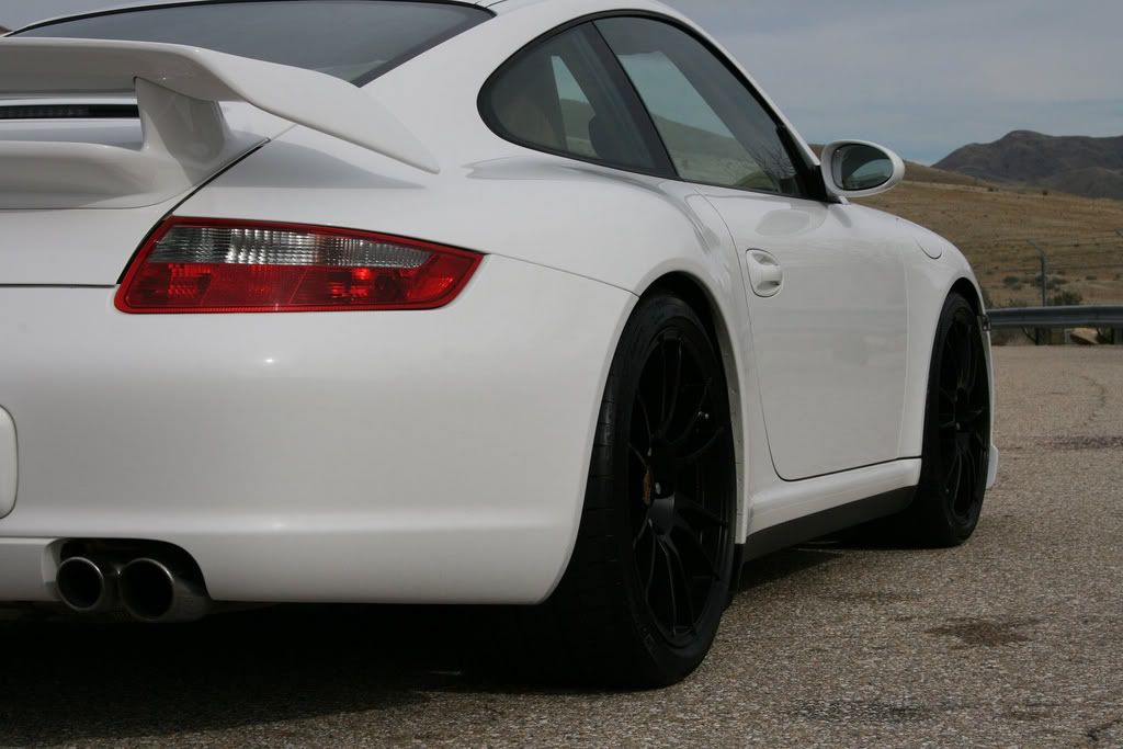

I would like to know if anyone had experience with fitting a 19X11 ET40 wheel on a WB 997 and if there were any rubbing issues. Thank you!

That's the offset i want to run on my 997TT
I think it's 11mm wider than stock and it wont rub. On WB people use 15mm spacers on the back wheels without problems
I recently found out that my car has 20mm spacer all around and i never had problems at stock height Even at the track

OZ Ultraleggera on WB
8,5Jx19" ET53
11Jx19" ET40

19x11 +40 will work all day on the wide body!

Nice, that's exactly what I was looking for. I just placed my order for the 19x11 ET40 Ultraleggera HLT today!

very nice fitment and pics. Looks great
WOOZY, lighten that exposure abit and post another pics so We can see those wheels. They look sweet on white man. Nice car
